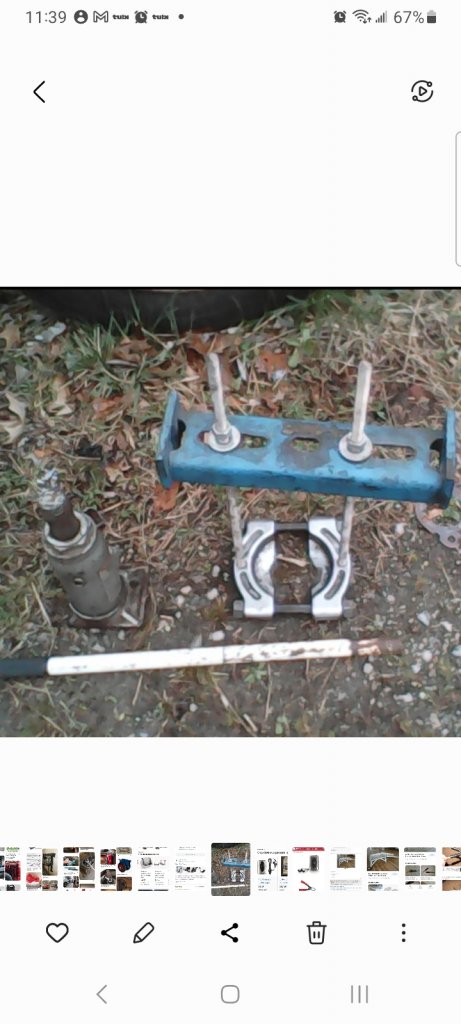

Here's what I use for pulling pinion bearings,diff bearings,crank gears, just about everything. Dirt cheap and super versatile.

One thing to note with the clamshell pullers, is that they are meant to pull on the cage with the outer race in place. The first time I used mine I did not do that, but now I do (pull on the cage w/outer race).
Kind of voodoo but it works and doesn’t hurt the bearing.
