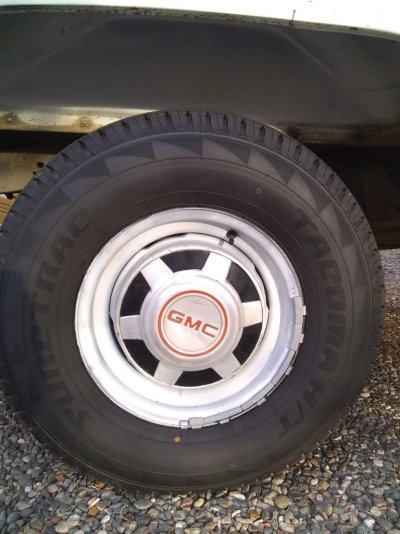

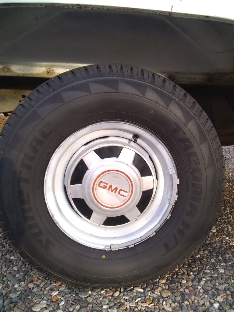

I have the stock hubcaps on my 84 Sierra C2500, but only one is shiny like original. The other 33 are almost milky in appearance. I have tried 0000 steel wool, soap pads but nothing works. Anything I can do to bring the original shine(anodized) back short of replacing them? I'm needing to replace a couple eventually as the PO used one as a BB gun target, and the other is dented in the center.

Show us some more pictures of that truck and the other hub caps, please. Is that the good one or one of the bad ones that you are showing?

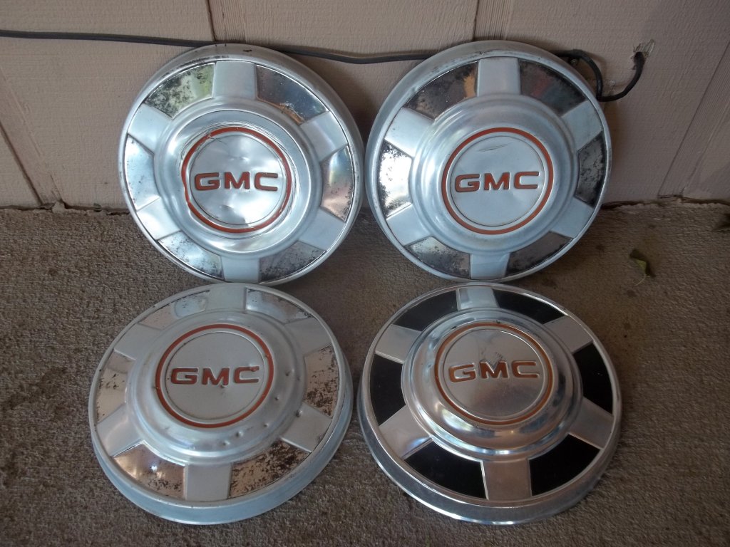

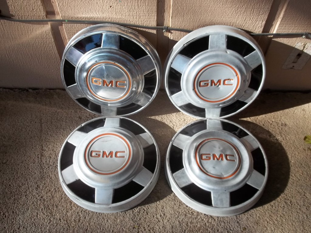

Here's my caps in November 2019 when I bought the ruck. I have one good one, and as you can see in the before and after pics, the other 3 aren't so good. I will be eventually getting the truck painted in Strata Blue(USAF) and hope to get 3 more good caps, but thought I'd try my hand at restoring these for now.
