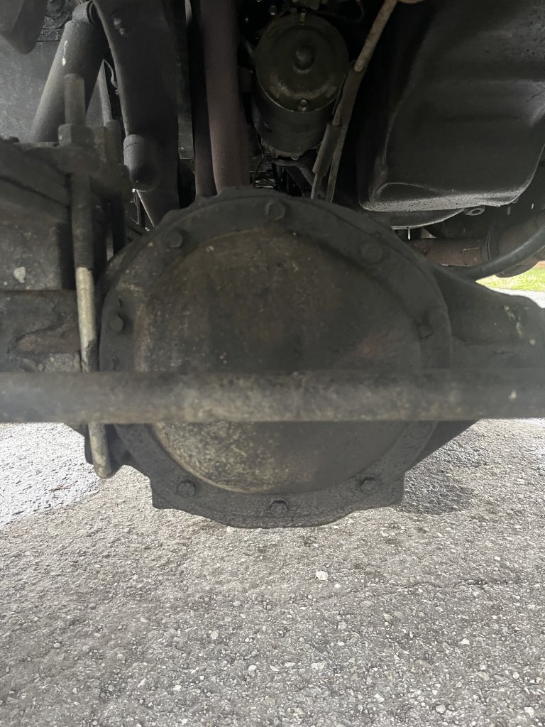

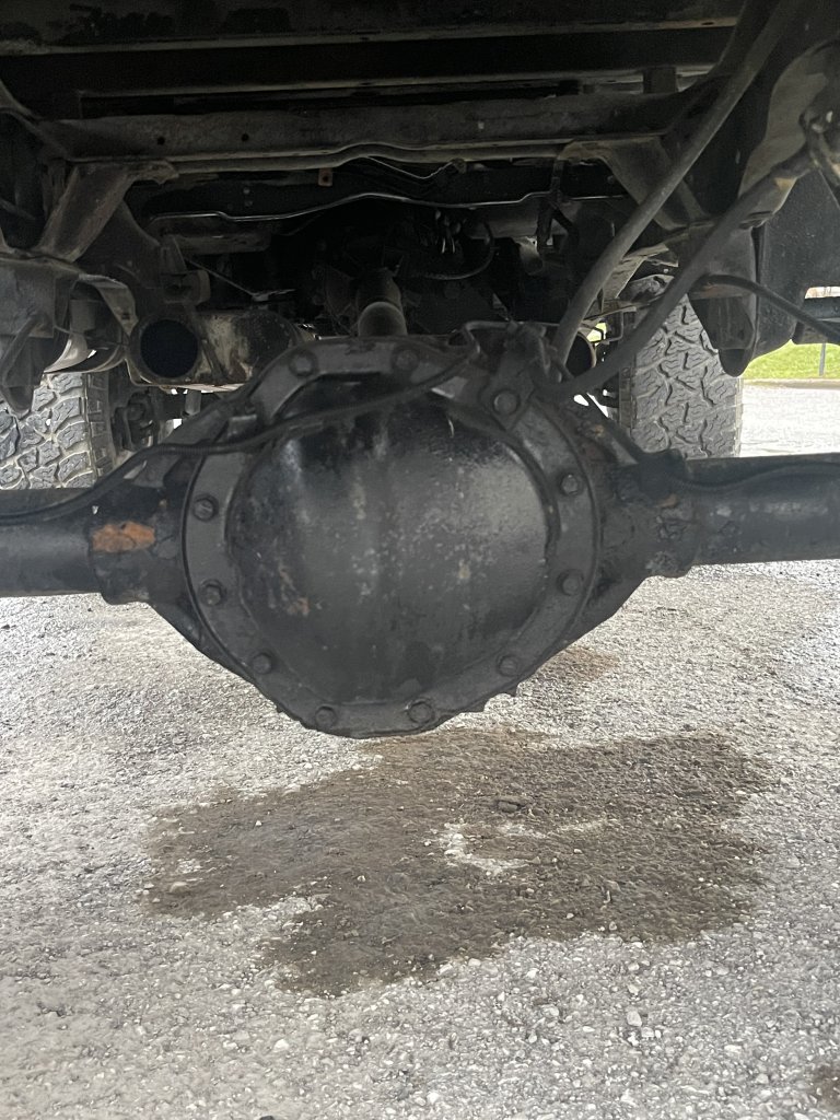

I have a 1981 Scottsdale, 4x4. I have pretty bad leaks in the front and rear diffs and was going to drop the covers and get everything cleaned up and new gear oil put in tomorrow but I don’t have any sort of tags or anything on my diffs and have no idea at all if I need limited slip additive? Any help is appreciated I will attach pics of my front and rear diffs in case that helps.

If you still have the original spec sheet in the groove box, itll most likely say if you do or not.
Most likey you have an Eaton Mechainal locker (type of Limited Slip). An additive will be helpful for that if that's what you have. I used it in my eaton, and it helped it.

@AyWoSch Motors i don’t have any of my factory diagrams or data sheets. Truck, engine bay, inside of the cab (including the glovebox was all painted and all stickers were removed by previous owner.

Bummer.
Well as far as I know, theres no way to tell what you have until you pull off the cover. You'll know as soon as you do though

The GM G80 differential is not a limited slip, it is a locking differential. Yes it has clutches but does not require an additive.
Use 80W-90 or 70W-90 gear oil. Old oil seals may not like synthetic oil.
When you pull the rear cover to replace the oil, the G80 looks like this:
To test for a G80 without looking inside, jack both rear wheels off the ground. Trans in park or manual in gear, spin one wheel by hand fast. The G80, if working correctly, it will lock.
