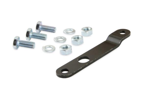

Did the issue with the terrible linkage ratio come up? People with auto trans have learned to live with it. Those with manual trans like me couldn't. I wasn't willing to engineer new bracketry after spending $1000 on a piece of junk that kept failing.
This $16 part will fix the stiff linkage issue. At this point they should be included on standard 4150 snipers imo.
