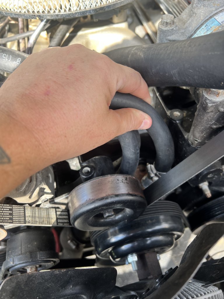

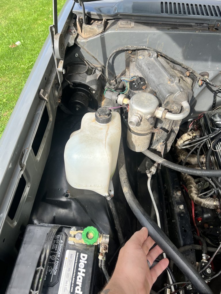

Top hose goes to radiator. Im also noticing that the bottom large hose on the radiator isn’t getting warm either.

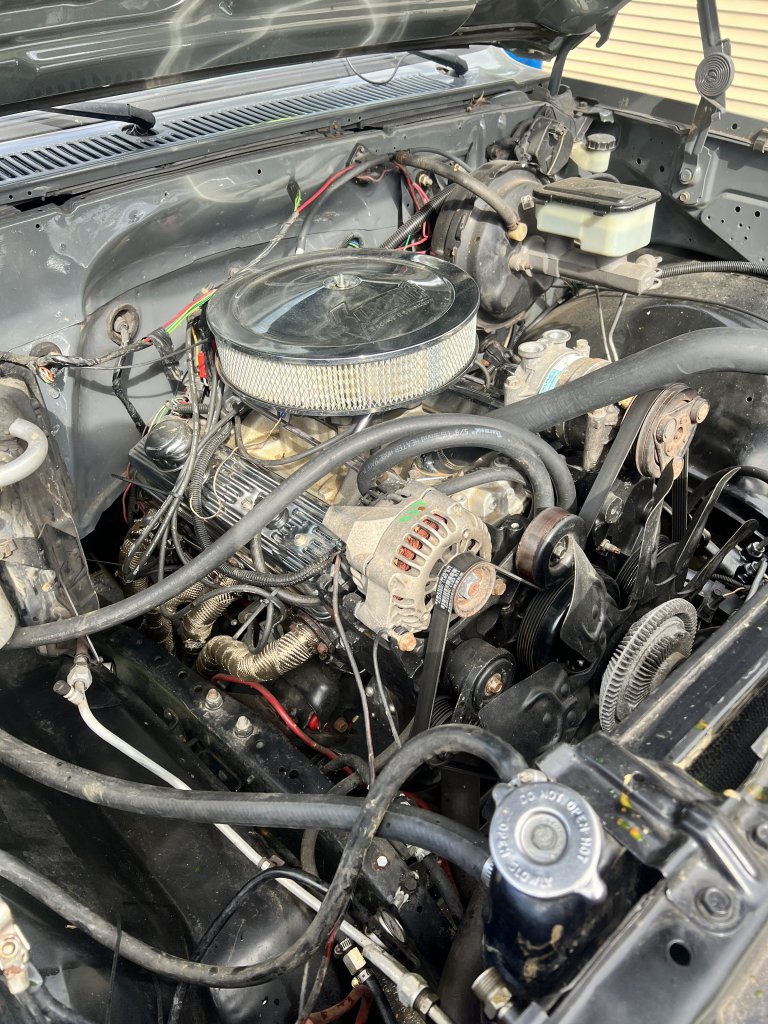

Second heater core line does go right to the water pump

So basically what im gathering is i need to move the heater core hose from the water pump to the intake. Should i just buy plugs to put in the place of the hose on the water pump? The hose that is currently on the intake runs directly into the water pump as well.
Yes, that is your problem. Someone didn't know what they were doing when they swapped in that motor. You need to cap both of those inlets into the pump. Get rid of the hose from the intake manifold to the water pump. Connect heater hose directly to the connector on the intake. This will still allow the coolant to circulate through the engine and heater core without the thermostat being open(that's what someone was trying to do with that hose routing). The current hose routing has coolant going from the intake to water pump under pressure in a constant loop and the heater core is going from suction to suction, so you get no flow.

@Bextreme04 Couldn't the bypass remain in place, just make sure the inlet hose to the heater core comes off the intake? And the other goes to the water pump. And of course the outlet hose from the core goes to the radiator just like it already is.
12,022
19,130
Upon closer inspection, it appears there are two hoses coming from the water pump? Looking at the zz4 350 on the innerwebs, there appears to be a bypass port in the intake, as well as the heater nipple port.

Yes there are two hoses coming off the water pump. One is the heater core hose and one is routed to the intake

Should i just plug both the ports on the water pump and run the heater core to the intake?
