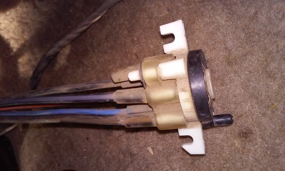

Hi all,
I've acquired a 1984 GMC K3500 that needs work. The dash and heater/AC controls came in a box. LOL.
I've been putting everything back together except, I have no idea what this is or where it goes.
any ideas?
Thanks!

Its the blend door vacuum control. It goes on your a/c/heater control unit. It routes vacuum to the blend doors inside your cab to direct air flow.

Hot Damn, Thank you!
