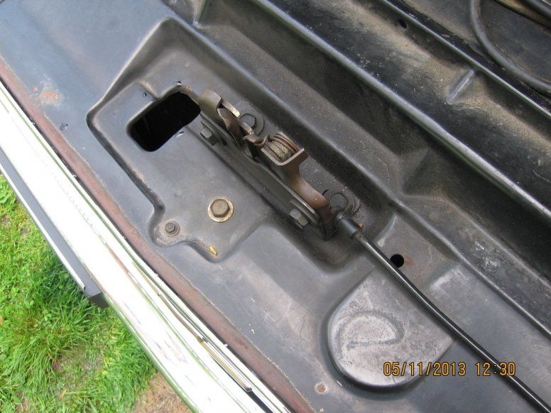

get a wood wedge and stick it between the hood and the core support right by the hood latch. you will be prying the core support down and the hood up a little. just enough to get the socket under the hood. use a half inch socket on a extension pull the 2 bolts out of the hood latch.
its pretty easy i have done it many times
this is the best pic i could find fast to show the bolts i circled them in red

i guess this picture shows them pretty good
Wow you can really get in there? That is a good trick. :D

ya if the grill is out it works better cause you can push the core down more

The wedge trick was what i was going to suggest
That's the ticket. Gonna have to remember that one !
