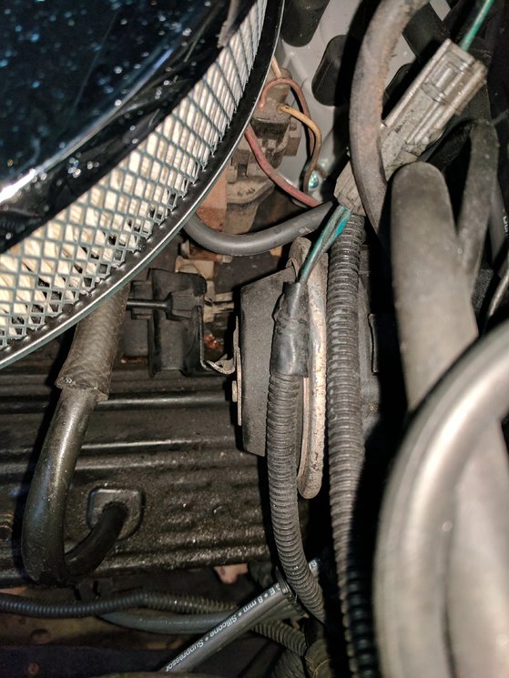

Can anyone help me identify and find this part for a 305 TBI? It's the hose/tube that sends filtered air from the air cleaner riser into the top of the driver's side valve cover. It's the one at left in the picture. The hard plastic elbow broke. I've also considered just putting a small breather in the valve cover hole but I can't seem to find one small enough. The hole seems to be about 1/2 inch. Any help with the tube or a breather that will fit is greatly appreciated! Thanks.

Try searching for GM part 14102133:
https://www.newgmparts.com/oem-parts/gm-crankcase-tube-14102133
$10.95
Or maybe 14101104:
http://www.corvettepacifica.com/products/16280/tube-vent-crankcase-air-cleaner-to-valve-cover-76-80/
IDK - your call.
14102133 looks right, but isn't listed as used with a 1985 5.0 TBI:
14101104 looks wrong and connects to the RH side VC but is used with a 5.0/TBI:

I've looked around, but I didn't see anything. No worries. They do sell mini crankcase breathers, but I think the reason that it looks like a universal parts store one won't fit is because that's the the side the PCV valve was on, and that's the grommet for it. Is your PCV valve on the other side? If you don't have one, I'd get one, put it in that side, and route the vacuum line per the emissions sticker. I can't remember if the other side has a grommet, but I don't think it does. You can get a crankcase filter with a fat tube and stick it in that side no problem if that's the case. If there are grommets on both sides, you'll have to remove one to stick a regular crankcase breather filter tube in the hole. Ahh, Jerry got ya fixed up.

Thanks guys! This is exactly the help I needed. It's part 14102133. The PCV valve is on the other side. I also realized from looking at the schematic that there's a grommet there. After all the crud that had built up I thought I was looking at the actual valve cover hole. With the grommet out I can put in a more easily available breather. Thanks again!
