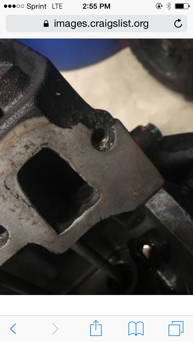

Cam is used it was in the shortblock I bought and rebuilt..I just cleaned it up the best I could with a brass wire wheel I also lauded a strait edge on it to make sure it wasn't bent in anyway .. Just ran into a new problem heads I wanted to pick up tomorrow (461 casting 250$ seem to be slightly damaged I blew it up for a closer look and inquired about it.. He claims it won't affect gasket sealing... Should I stay far away from these heads? Here is the cl add if anyone wants to take a look thanks all your help is much appreciated !
