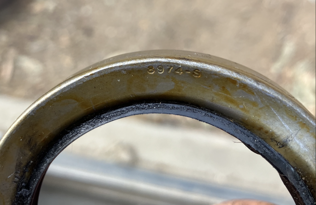

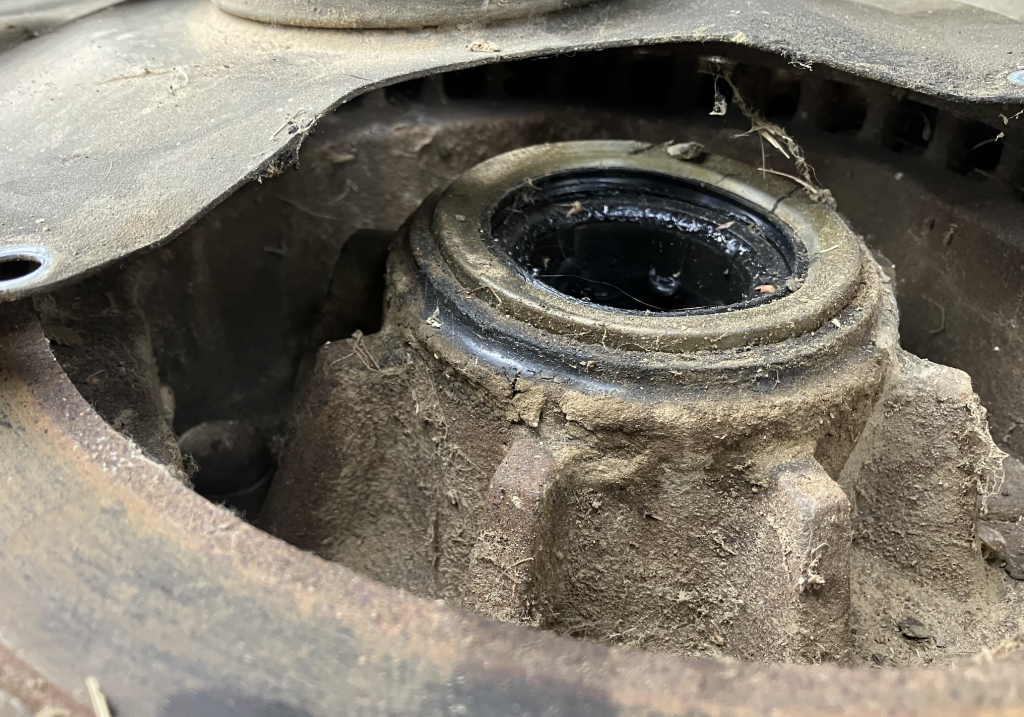

I'm confused by this same issue. Have a 73 C30 (originally cab and chassis but now a franken truck). Redoing the whole front suspension and steering. When I took the rotor/hub off the i noticed that the wheel seals were sticking out about a 1/4". The inner bearing also has no play in and out, which seems weird, i thought they always moved a little and the taper of the spindle locked them in place when installing.

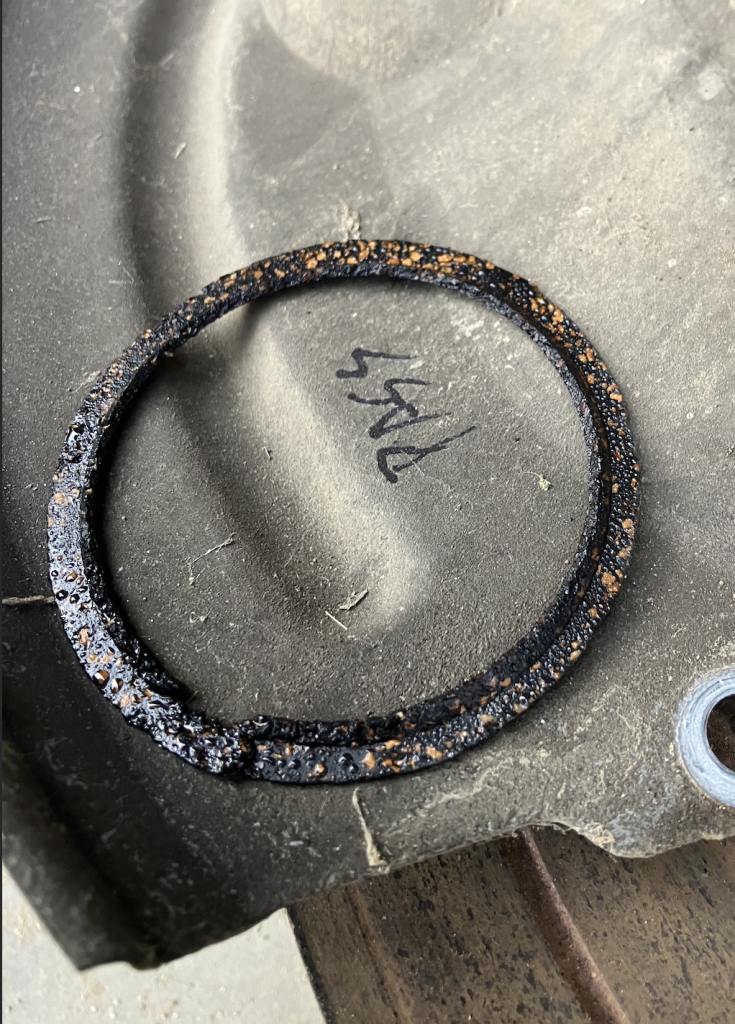

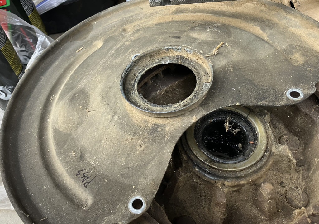

The backing plate had a cup in it that sticks out to receive the seal. Between the seal and the backing plate there was also a cork gasket which I've never seen before. I don't know how to find this from a parts store so i'm just gonna have to leave it out.
The wheel seals that were installed had the same part number as above: National 8974-S.
I went to Oreilly's and they had the 8974-S as the right ones and they were 1/2" thick. But they also had something cross listed on that part what was a replacement for the original and it was 1/4" thick which should install almost flush with the hub.
It did not look like anything had been leaking out of there so I will probably just install it with the same part number seal as the one that came out. Just wondering if this is how it was designed, I have never seen a set up like this before.

Some companies make that seal like National does, with no lip. Other companies make it with a lip on the back side. I've used both on squares with good results, and we sold them both ways at our parts store.

Thanks for the help. It all went in fine with that 8974 seal.
