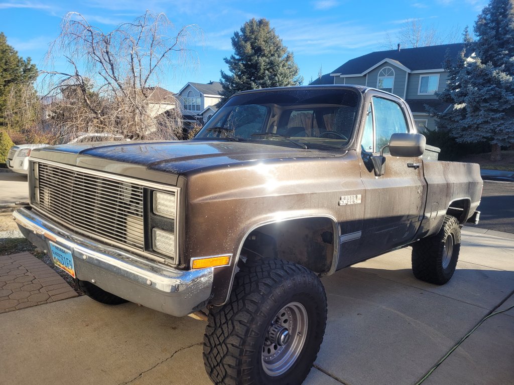

A fresh truck picture after the last snow.

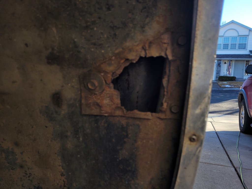

Is this rusted out access panel a common issue? Does anyone sell replacements or should I just make them? I could make them out of aluminum so they don't rust.

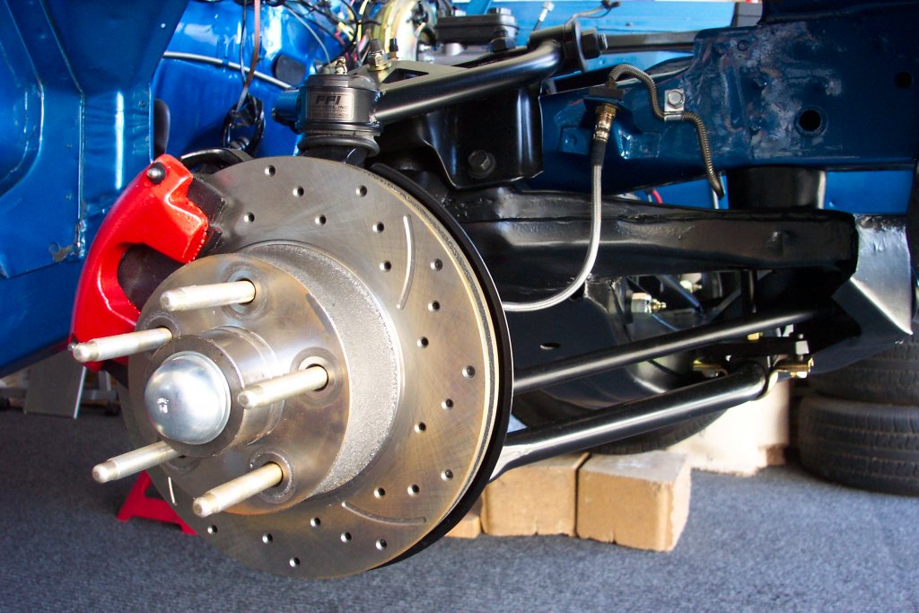

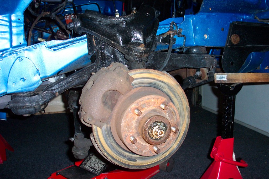

Thought I would post a couple pictures to show my restoration work and the level of work I do, or the level of OCD that makes me want to do the best work I can, so when I'm done and take a step back to admire my work, I can be proud of my eye for detail. I do everything myself because it is so hard to find mechanics that will do custom work that I can afford.
Hoping to do some fun restoration work on my son's truck this summer.

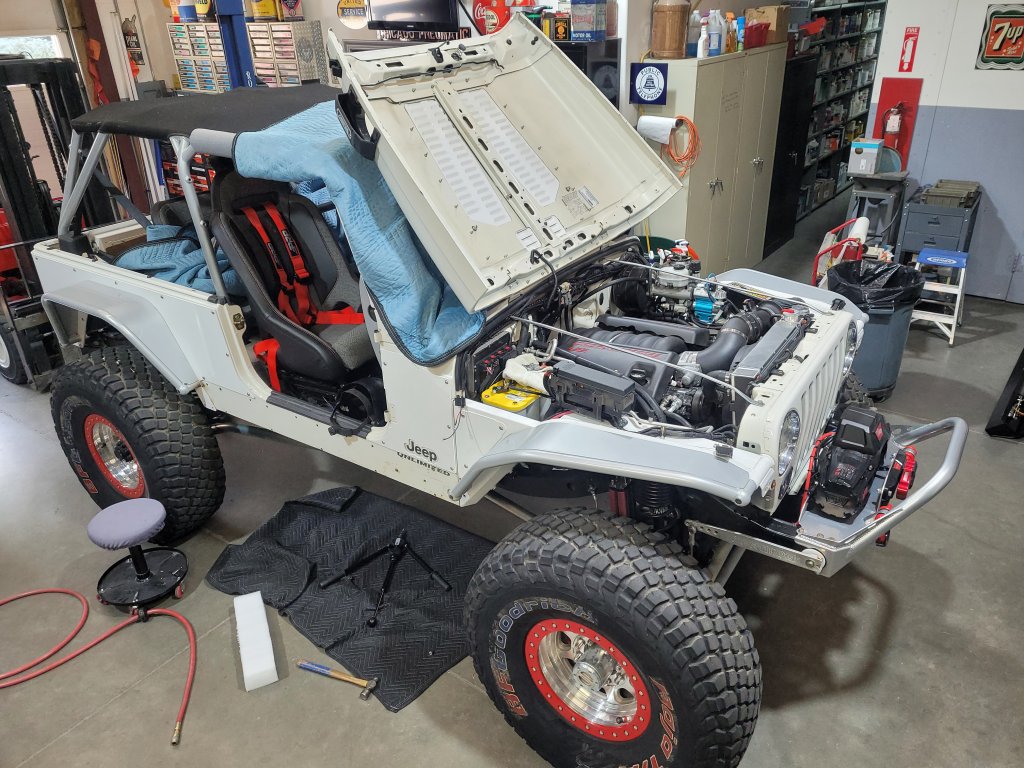

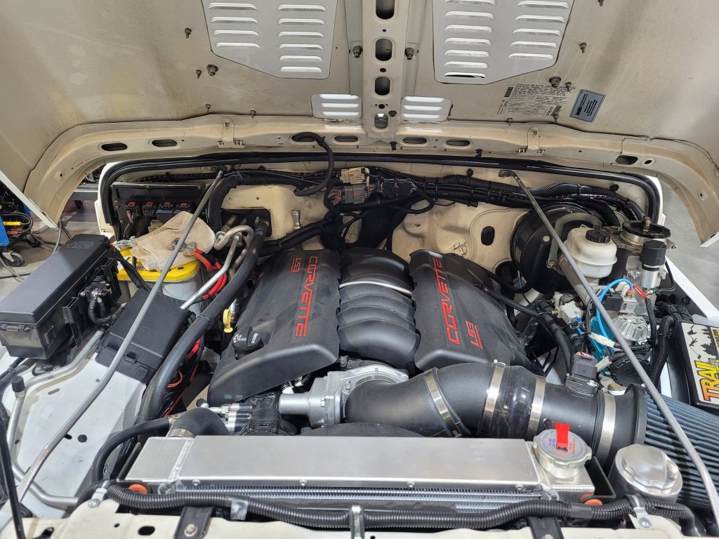

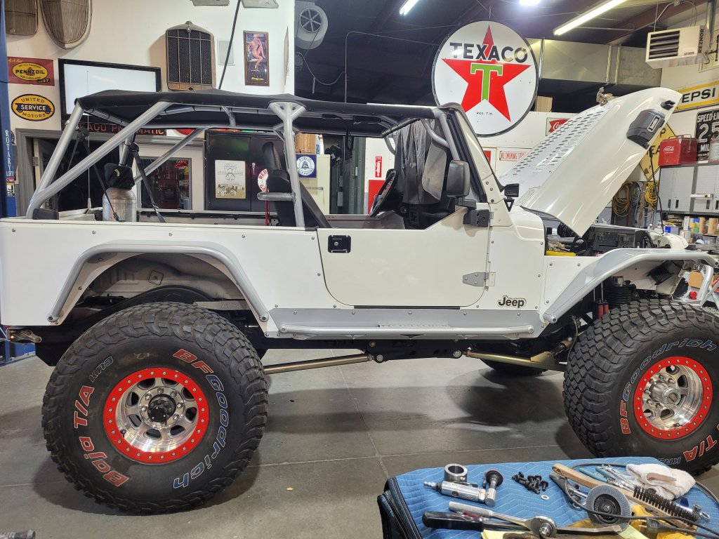

This is a high end project I did for one of my clients. I normally do home installations, home theater, internet/wifi, phone systems, multi room audio. Been working for this family for over ten years before he asked me to correct all the satellite tv and audio issues on his motor home. Then he started asking me to help with metal fabrication work on different projects. I helped with modifying rock sliders with pop out steps to fit on the jeep to work with the existing fenders and did all the electrical wiring for the automatic steps.
The jeep is tall and the wife is on the short side. After he had the conversion done to add the corvette motor and trans with a second computer to the rock crawler jeep I was tasked with trouble shooting the left over electrical issues with no map or diagram of the changes the mechanics made to his wiring. All I had to work with was logic, a test light and the original wiring diagram for the jeep before it was modified. It was a challenge, took 10 hours just to figure out how to get the air conditioning to work again.
Apparently when one of these conversions are done the original computer is still needed to control the dash, gauges, interior lighting, etc. But it also needs a second computer to control the engine and trans. It's a challenge to move sensors from one computer to the other and make everything work as if everything is normal.
The mechanics that worked on it before the conversion did a lot of electrical additions, adding some of the aftermarket relay and wiring systems. They didn't bother adjusting the length of the wires and instead just waded them up and tie wrapped them under the hood, I had to clean up that mess too.
This is part of the inner fender, welded from the factory to add support to where the whole front end bolts to the cab. One of GM's design flaws.
So yes you could make your own part, but removing the bolts does not release what is left showing now. You would need to grind it away.
A new inner fender is the best fix.
So, If I buy a new inner fender it will have that piece attached? My first guess was an access panel, but there was nothing behind it of interest. Thank you for solving the mystery.
Personally, I have only bought factory replacement inner fenders. They do have the piece spot welded. I do not know if aftermarket have the extra support piece welded.
That piece is on all, my 73 has them and I replaced the passenger side this year and it has it. Just get a new one, you have a issue with moisture not being let out at the bottom well below that piece. You'll figure it out when you remove it.
One of the previous owners really really like to play in the mud, I think I might get the mirror and flash light and take a look inside. I thought if was odd that the piece would be so far gone, but the much thinner metal around it only have surface rust.
Passenger side looks just as rusted.

Your question was brought up before and I posted pictures of both my wheel tubs driver side original and the new one. That piece as far as I know is not replaceable. I assume its a engineering add for some reason.

...... I thought if was odd that the piece would be so far gone, but the much thinner metal around it only have surface rust.
Yes, because the metal was spot welded with no paint on the inside of the 2 pieces.
Yes to make the mounting bolt area to the cab a stronger area.
