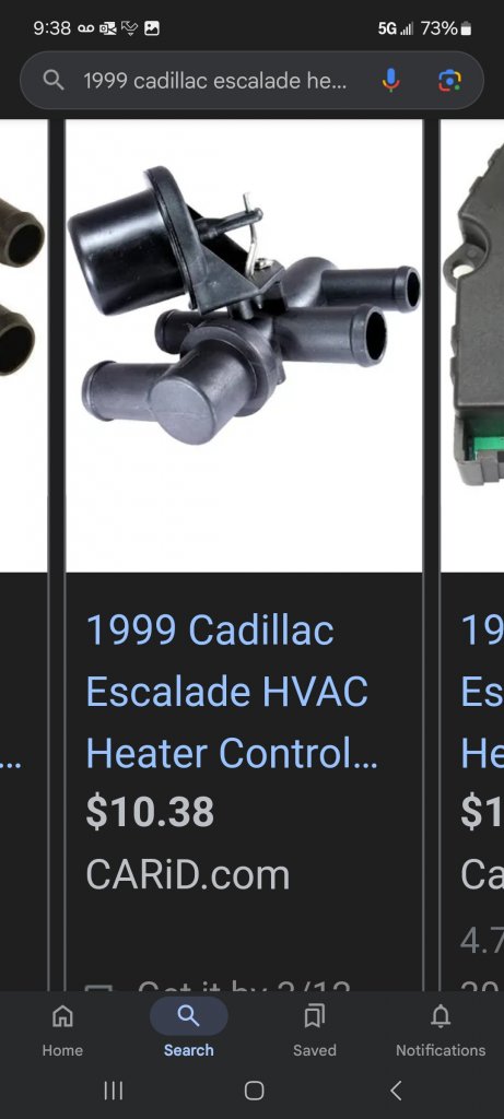

Looks like 1999 escalade would do the same,with nothing but a vacuum hose for switching
I've got one of those that I'll install on my Suburban. One day, lol.
On a manual heat (so no AC) youd have to either rig up a vacuum switch or go underhood and have a vacuum line off your engine either capped or hooked up
for a non AC vehicle, using a ac vacuum ball might be wise so then you can keep the heat out of the heatercore even when its accelerating with large throttle
Im not sure how much temp this would lower the cabin, but id imagine it would be considerable when moving slowly , less radiant heat from the dash

There was a heater shutoff valve on some vehicles, but I’ve never figured out which ones.
I found a two port vacuum-operated heater bypass valve several years ago. With vacuum applied, the heater water flow went from the engine to the valve, made a u-turn and went right back to the radiator, without going to the heater core.
It worked fine to change the water flow, but the air flow still seemed to pick up some heat, so it was never really cool air unless the A/C compressor was on. I ended up connecting it to activate the bypass valve using the vacuum line for recirculated air, so it bypassed the water only if the system was in Max A/C mode. It worked, but I took it off later during one of my many engine modifications.YMMV
14044414 original valve part number
this is for a S/T truck in the 90s but it should work. uses one vacuum line, intended to be sourced to the "MAX AC" position (which recirculates the air in the cabin) with a vacuum valve, and just tie into that
could be put to manifold vacuum manually in the warm months or tied to the vacuum function of the truck if yours has factory AC.
