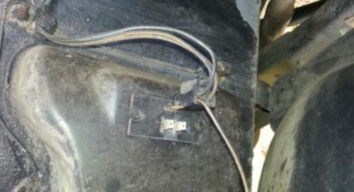

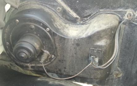

so just to confirm 1low4x4, this fix would be for the non-ac rigs right?
Easy fix for that is to push the upper tab down then plug the connector back in. This keeps the damn the damn blower from running all the time and burning up. Still works when you want it to and only then.
byproxy
Feb 25, 2013
7
Nick
K15
350 V8
so is this the plug? if so, mine does not appear to have the prong bent down in the previous pic/post. am i not looking in the right place??

Ahh you have the heat only setup nice. :popcorn:
