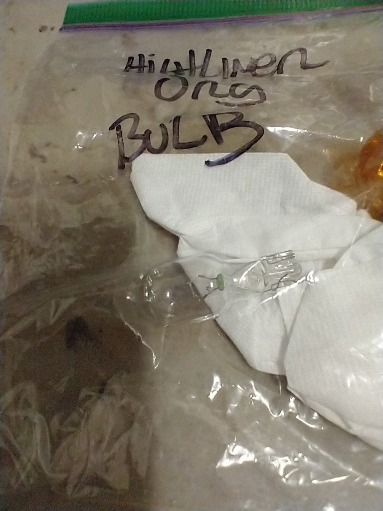

I did check and I have no taillights but do have headlights. It's not the factory bulb socket because it a Highliner headliner. From what I've seen with LEDs you just flip it around normally if the led doesn't come on. When I flip it around it doesn't come on with the doors open or closed. I do have the regular bulb for it though. Today my new headlight switch came in but haven't had a chance to get back to it yet. I'd love to put my hand underneath the dash unplug the switch and grab it from under there but because the AC tube that goes across their blocks everything maybe it's better if I just take the cluster out that way I can verify the prongs are all the way in on the harness end to cluster. I noticed on the new rheostat you can feel the springs notches as you rotate it, I don't feel that on the old one that is in there. I can't wait to see if the headlight switch improves anything. Do the early square body's not ground at each light in the rear? I seen a schematic that shows ground on the passenger side as well. My truck was made in late 74 for the first month of 75 it only has it on the driver side.

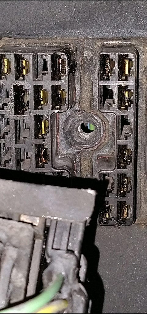

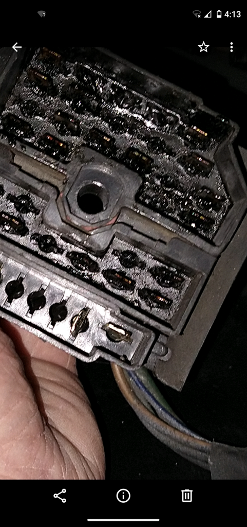

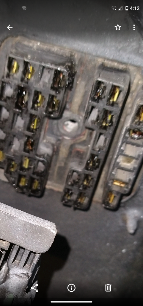

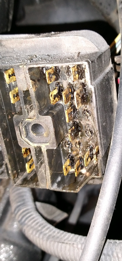

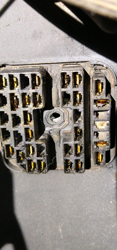

Things kinda leaning towards my feeds so I pull the bulkhead connector and the 46-year-old dried out dielectric grease is caked all over the posts and not in a good way. So I worked on cleaning them. Something is not feeding the rear circuit and something is making a turn signals go into flash mode. Wth man
squarelyfe
Nov 8, 2021
174
104
NORCAL USA
Larry
k25
Some before and after.. I know dielectric grease is normally a good thing but in this case it's rock hard and it's covering any clean contact these post I don't think it's a good thing so I got it out of there.

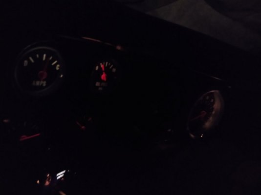

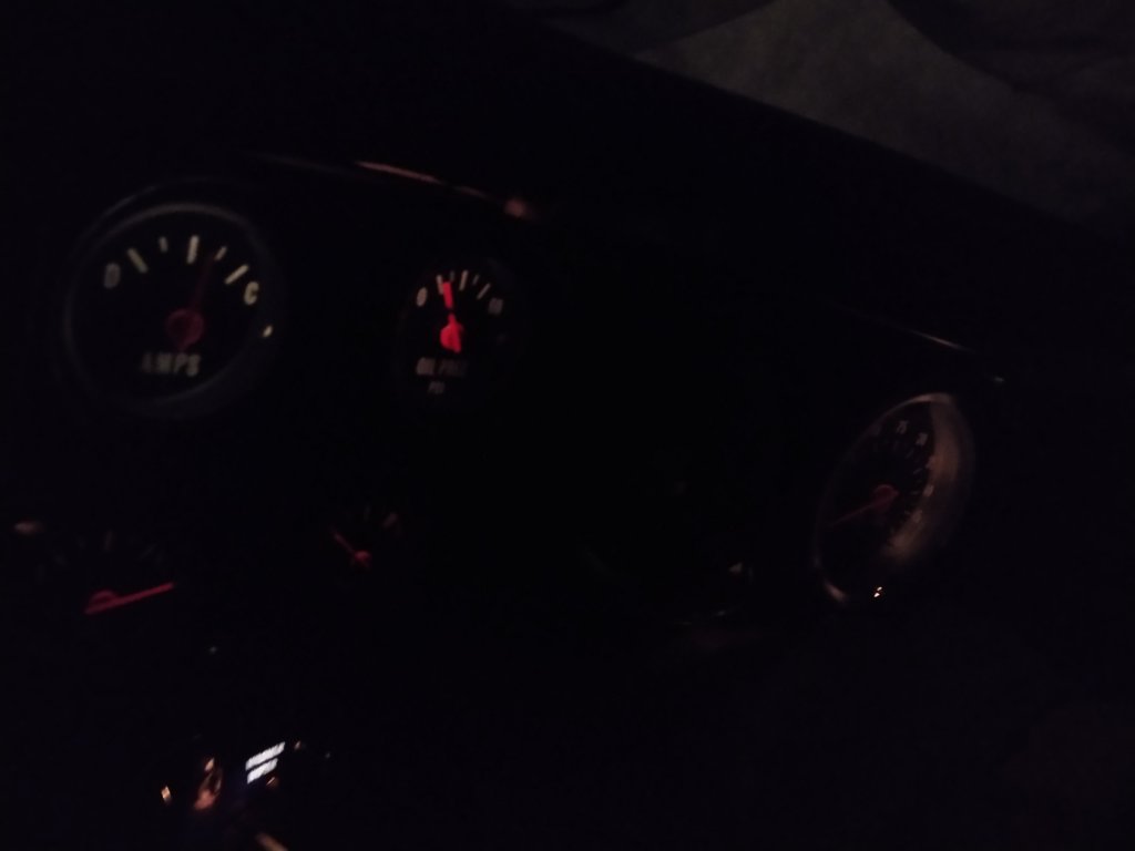

Lol it took me to read what I wrote here to follow my steps I realized I forgot to plug the intermediate harness into the rear circuit after I was probing around earlier today. I now have cluster and rear tail lights/side running working lights in front parking lights come on everything works except for when I hit the turn signal it goes into hazard mode where they all blink. Come on fellas someone must have gone thru this or have an idea I'm so close! I'm going to see about testing the flasher module tomorrow. If my horn isn't hooked up could that be a problem with this turn signal flasher mode? Does the turn signal cam get ground from the horn circuit?
I'm Also interested in some led bulbs for my dash since a few are out.
