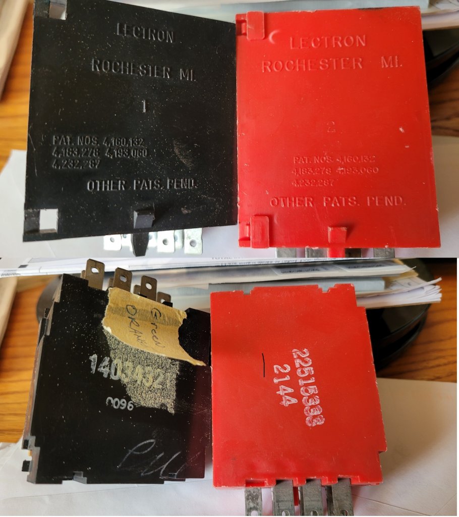

I found my last one at a junkyard. GM used the same alarm type for a lot of years
If I remember correctly the only difference is the 6 pin doesn’t have headlight alarm. It will have key & seatbelt alarm.
7 pin headlight, key, seatbelt alarm
here are some parts numbers
22533568
22535998
19245591
15042437
15042437
15969639
22529441
15557321
22521438
and probably many other numbers .

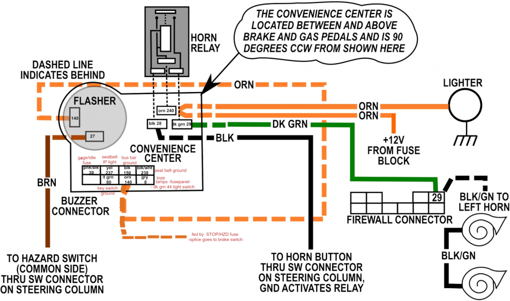

Can you post a pic of where this goes? Mine doesn't have one so I pulled power from the headlight switch to a reply and connected my own 'beeper' to it but hate the tone of it. It works but I'd like the factory buzzer.

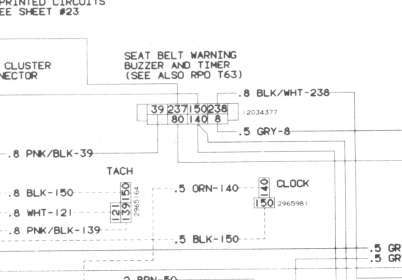

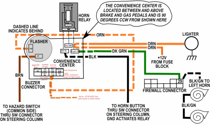

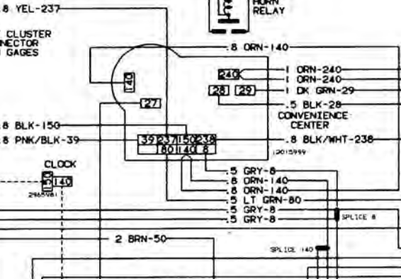

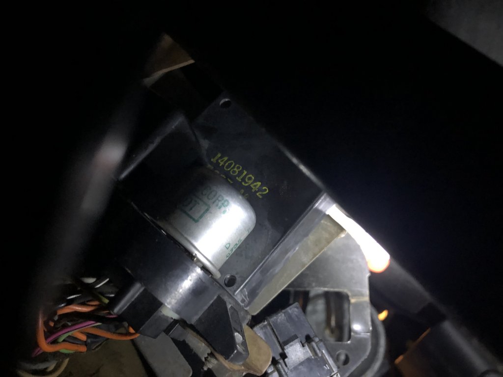

85 on, it is located in the "convenience center". Roughly above the brake pedal- also where hazard flasher is.
A lot of the GM buzzer/alarms are interchangeable- they may have different alarm/buzzer chime tones.
Different colors and different tones / patterns for different functions.
