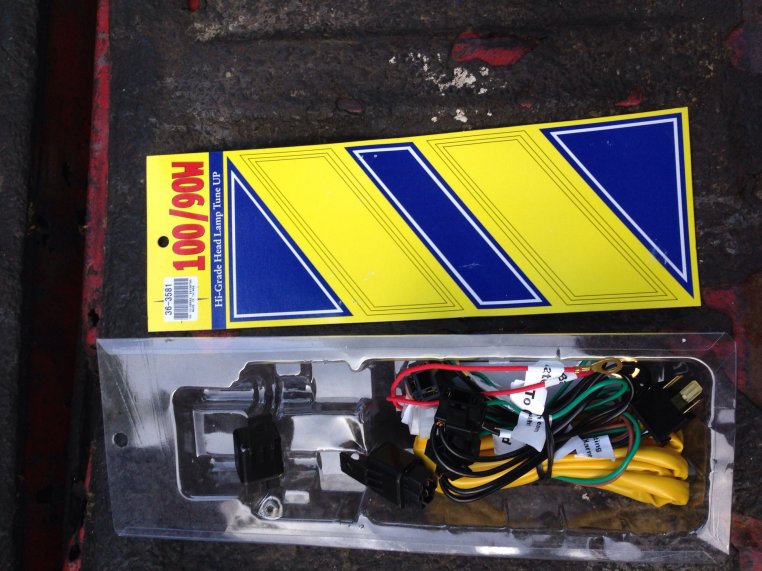

I bought this headlight upgrade 7 months ago from lmc for $30 and finally installed it after I fixed my high beam switch. I am familiar with this type of setup from an upgrade to a *** bike I did. It is pretty simple and everything is labeled in English and Chinese.
Normally current goes thru the headlight switch and then to the bulbs. Not a big deal if you are using led's or hid's but with halogen every watt counts and the longer trip eats away some of your brightness. This plugs into 1 low beam plug of your existing wiring. Hook up grounds and power and then your 4 plugs and you are done. Took maybe 20 minutes mostly because I had to take the battery out and drill holes for the grounds.
It is a definite improvement and when I turned on high beams, all 4 bulbs stay on. Added bonus for those of u wanting to do that mod.

Ok I guess the "added bonus" is just it working as designed. I"ve had other vehicles that it was one or the other, maybe my 69 Cutlass but anyways. I thought I read a post on here of somebody who wanted both bulbs on while using high beams.
The purpose of the harness is to provide direct current from the battery to the lights without going thru the headlight switch and all associated wiring. I upgraded the low beams to Sylvania something or other last year but left the high beams with the el cheapo bulbs that were in it because I could hardly use the high beams.
I would guess its about 15% brighter and it makes a huge difference when the highbeams are on. I had a similar setup on a Kawasaki motorcycle, single bulb and had similar results.
