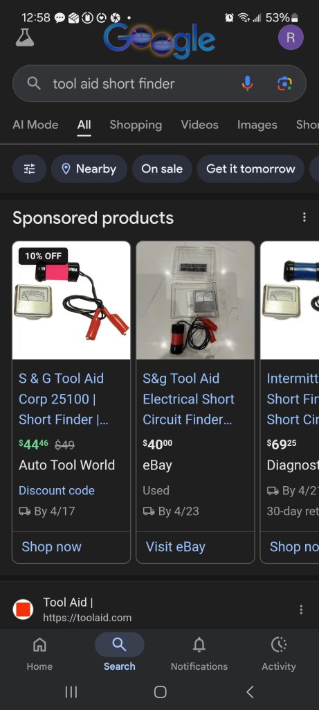

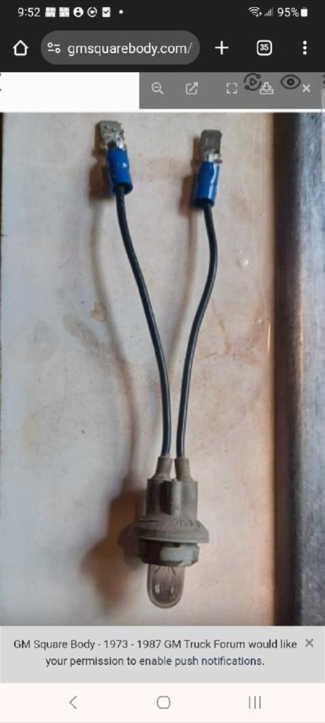

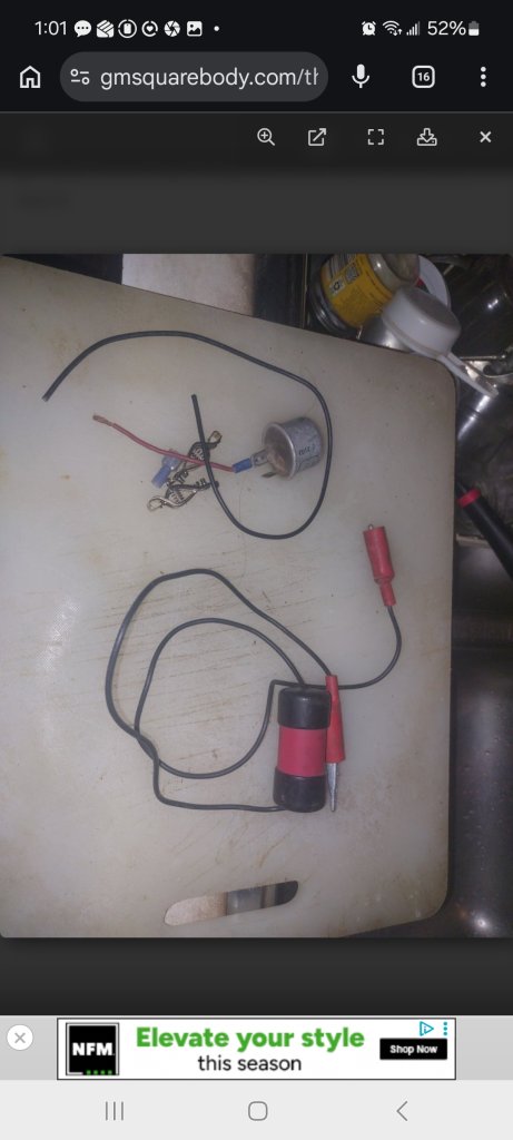

They make a device just for tracking shorts I happen to have one I bought decades ago. I'll try to get you the name and a pic. BRB. Okay got you some pics the red thing with the jumpers is just a self resetting breaker. The way it works is the wire shorts creates an amperage draw you trace it with the ammeter to the point where the draw stops that's where your short is. The breaker keeps popping to prevent burning up the wires. The 194 bulb with the spades. You plug the bulb in in place of the fuse. The bulb becomes a load,which prevents the wire from burning. Turn what ever you have to to get the bulb to light. When it's lit the short is present,start unplugging things,shaking wires etc. until you find something that puts the light out or shaking something makes the bulb flicker. There's your suspect short. 2 methods,both work great.
