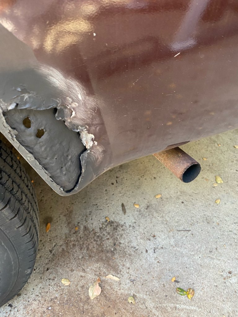

He's had her since the early 80's (before I was born) and has quite a lot of sentimental value to him, she's seen him through 2 divorces and helped haul us 4 kids kids around (I learned to drive on her). Anyway he's up in the Bay Area and the truck has been parked outside pretty much its entire life so as you can imagine the rust on her has been building up for quite sometime. About 10 years ago I got on him about it and said if he wanted to keep that thing out of the scrap yard he had to do some body work on it. He invested a couple hundred bucks to a shady tree mechanic for what, in my opinion was a pretty crapy bondo job and some parts swapping. Cut to a few weeks ago he sends me some new pics after I asked how the truck was holding up and I was honestly shocked how bad it had gotten (Ill try to attach pics bellow). She still runs pretty strong with the original 350 motor, drives straight and I dont think the frame is rusted out (although im not sure i would be able to tell).
Ill cut to the chase here, What are my options? Is it beyond saving? What sort of costs are we looking at here? Do you have any recommended body shops in Northern California or even San Diego? Is it worth it to take it on myself?

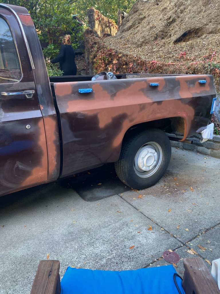

For what body shop labor is in Northern CA, I’d be tempted to buy bedsides from one of the online retailers if you can find a decent bed on CL.
If you can find a donor cab with rotted out floors, corners and cowl, you might be able to snag it up relatively cheap. You’ll only have 6-8 inches to blend on the b pillars and an inch or two on the a pillars. Not a whole lot of welding to replace the roof. Mostly some careful measuring and cutting.

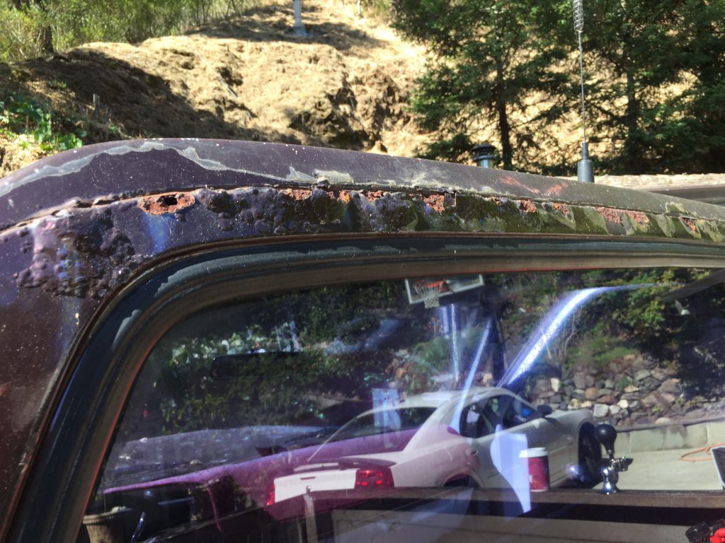

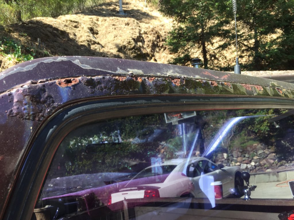

Yea I shopped the LMC catalog a bit looking at panels, I think I can handle swapping those out but Im not sure my skills are up to cutting and blending in a whole cab top. My welding skills are sub-par at best. Most of my mechanical expertise has been in Motorcycles and doing suspension work on my Tacoma. How big of a job is it? Im thinking that the rear cab above the window is the worst of the rust on the truck, is there any other way of repairing it short of a cab swap?

The seam over the rear window looks terminal...
That is a $2000.00 fabrication by an expert body man in steel.
The fiberglass work required to fix it is extensive. High art...
The main problem is if you ever roll over, your cab is compromised where safety is concerned.

Whether it’s worth saving is dependent on your budget.
Seriously doubt the frame is compromised and the “rest” of the body besides the cab is comparatively easy.
The rear quarters are just “normal” typical rust. These trucks don’t have structural rust, frame, until they are 1000% worse than that.

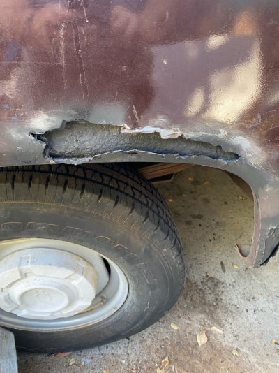

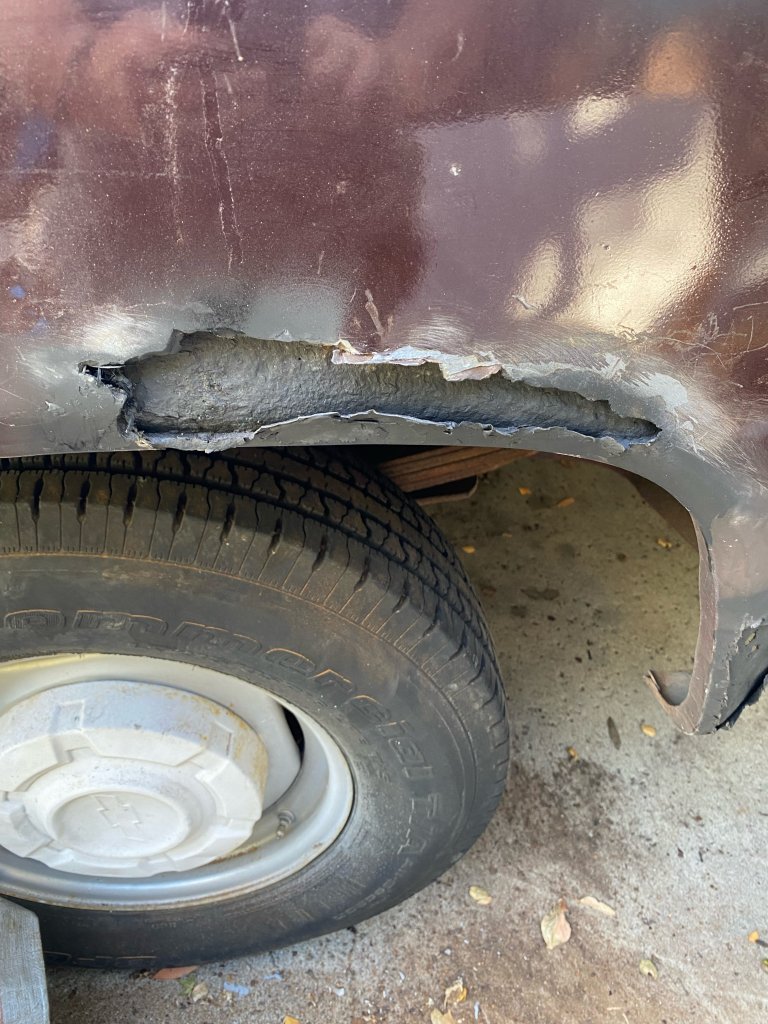

Rear quarter rust, fix with patch panels if can do or pay for bodywork. If rest of bed is good. Parts cheap. Bodywork intensive.
Or replace bed sides. Parts $1200-1500 and not bad diy work. And the rust is magically gone and no extensive body work needed.
Or easy button and cheapest option given your location. Find another bed with no rust and not banged up and swap it.
Same w front clip parts but you didn’t post rust there.
The cab is trashed though, if you intend to do any real long term, proper repair.
The seam sealer failed there and no one fixed it. To fix it right, cab is junk and also easy to source clean and not too expensive in the PNW. But have to disassemble the whole truck and reassemble.
Tedious and have to be pretty handy. But overall the best option. That is the worst spot but not the only rust on the cab if that is that bad. Guaranteed.
Given where the truck is however, the reality is the ONLY reason to restore that (due to the roof rusted out) is for sentimental value. The roof rust makes it worse than 90% of trucks in the PNW. You could buy a 70s C10 no rust, not running for a couple-3 grand tops and swap a motor and some parts AND paint it the same color as pops truck for arguably the same $ as just the bodywork on that truck.
