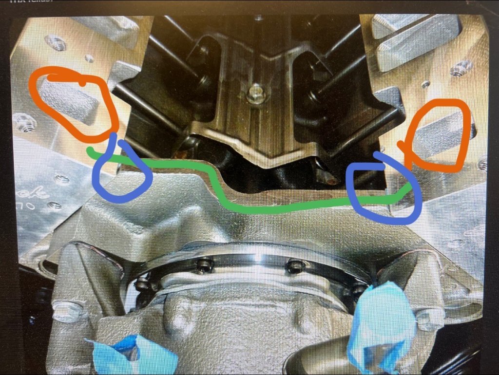

Are these the areas (corners where the heads meet the block) you're referring to?

for a visual reference.. The green line is where you place the bead of silicone, the red lines are where you lightly smear some silicone to aid in sealing the water ports to the gaskets, and the blue circles are that place where you have 3 different junctions all coming together between block, heads and intake and you want to make sure there is sufficient silicone to fill the gaps created at those junctions between mating surfaces and gaskets. If you do that, you should never have any leaks, water or oil.
