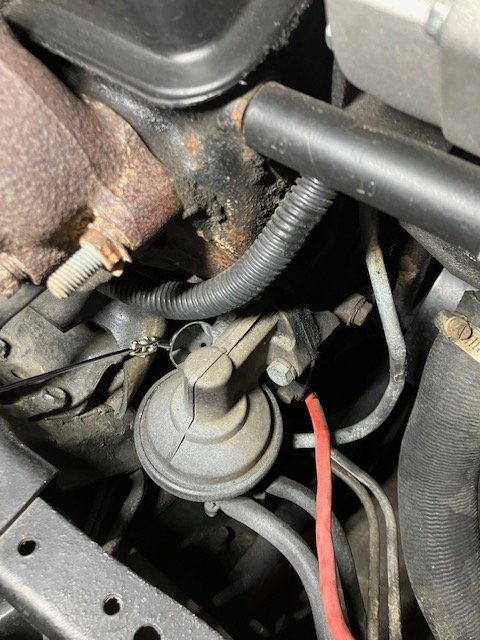

I jumped in the stock '84 C10 yesterday to head to the store and started smelling gas about a half block away. I pulled over and raised the hood and saw gasoline pooled on top of the fuel pump. I couldn't see where it was coming from so I headed back to the house and turned the engine off. I opened the hood and by the time I found a flashlight to take a look, the gas was gone. I jumped in the car and went to the store.
Late this morning, I started the truck and fast idled it for about 10 minutes and found no sign of gas, anywhere. The temperature was 45º and fuel gauge is a little passed F (I recently filled up). My canister is connected to a steel vent line and the 3 line fuel pump was replaced by a shop in late 2018 and I've put 6k miles on the truck since and have had no problems. I don't know what brand the pump is and I could not easily see a vent hole so I grabbed a mirror for a better look and believe I found a hole on the back side of the pump. If that's where the gas came from, what would cause itThanks. to happen? Should I fix something or just keep driving the truck until it happens again? I've been through an engine compartment fire while driving my '81 TR8 and do not want to go through that again.

Interested to see what you find out. I had the same problem a few years back and couldn't figure out why it would randomly happen. Maybe leaking at the seam occasionally is all could come up with. I replaced the fuel pump pretty quickly and of course that took care of the problem.

I had a similar problem, and they gas mostly went onto the exhaust manifold and burned off. Gas smell, but no visible gas residue. Just replace the pump and be done with it.
They aren’t expensive, and not that hard to replace. The only challenge is to get the pump lever up under the rod in the block. I used an old hacksaw blade bent at an angle to hold the rod up while I slipped the pump into position. Also make sure you use a flare nut wrench to remove the metal lines from the pump. They might be tight enough that a normal box end wrench will just round it off.

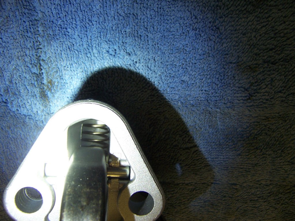

Had 2 that were junk out of the box. 3rd time bought Delphi or GM can't remember. That one has been fine for 2 years now. Bought extras while they were available.
Defective pumps did not have a return spring on top of pump arm, stuck at 1/2 travel.

I ended up paying $69 for what was supposed to be an ACdelco OE pump. It turned out that the box was original but the pump had a round symbol that indicated it was foreign. The pump arm spring was internal and not external like many show. I’m not sure which position is OE. I put it on and will see how long it lasts. Carter has changed hands a number of times and I believe is now a part of the Trico Group.

Return spring on top of arm is oem style

Check your oil,level and smell. Fuel on top of the pump,that's a new one. With idling I'd put pressure on the steel line from the pump to the carb look for a leak above the pump running down or spraying on it. If your oil level has risen or smell like gas you probably have a pump out. Thing is I've never seen a bad fuel pump put fuel on top of the pump they always leak from the weep hole down.

Do you remember if they had the return spring?
No they did not.But they were Delphi.My Carquest"by Carter" pump does though.My original pump from factory had a return spring.I replaced the original pump in about 2003 and it def. had that spring.
