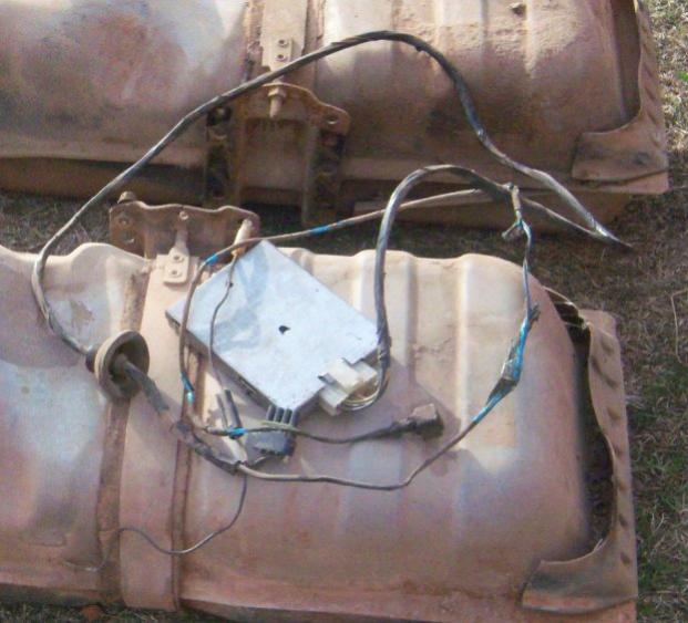

No, the ECS computer, or C3 as its called, is a box about the size of a desktop computer hard drive. Then the harness comes out of the firewall right behind the distrubutor on the passenger side. So what it has is the 4 prong plug that goes to the dizzy, and the wire that goes to the knock sensor on the passenger side of the block about say where the center freeze plug would be. All it really does, it advance the timing as far as possible without pinging. Its exactly what is says it is and nothing more. Electronic Spark Control. There there is another C3 type system also that will have leads to the carb and meter the A/F mixture also along with the ESC. But, heavy duty also has it too. I know of an 86 3/4 ton with 454 had it. Not cats, either. We swapped in a standard HEI dizzy and recurved the dizzy for a bit quicker timing advance and it worked great. But now he must use 89-91 octane of he'll ping cuz timiing advance comes on a bit to much to quick and he don't want to back it down any.
Here is a photo of the ESC computer ECM and the wiring harness to it. That's all there is to it. This is the one without carb control too. You also see the grommet where it comes thru the firewall.
