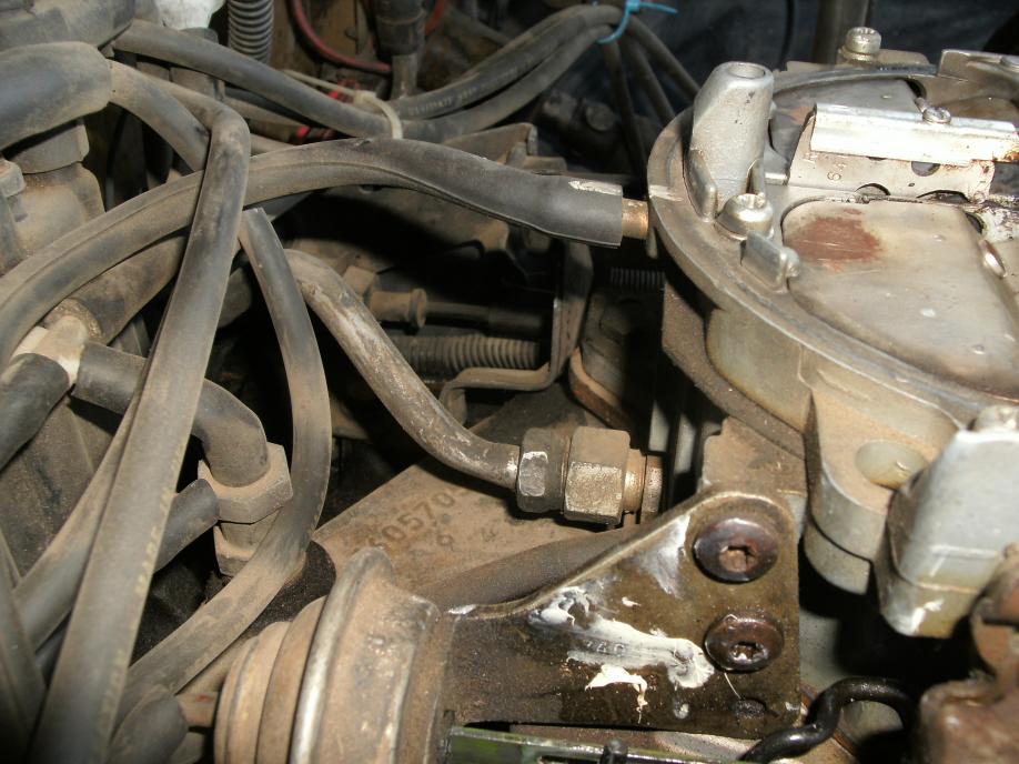

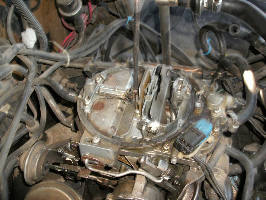

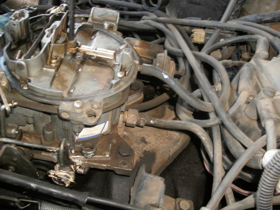

Here's a pix of my carb....in all her vacuum glory! LOL
What exactly is the screw adjustment right ot the top facing up in front of my primary ports?

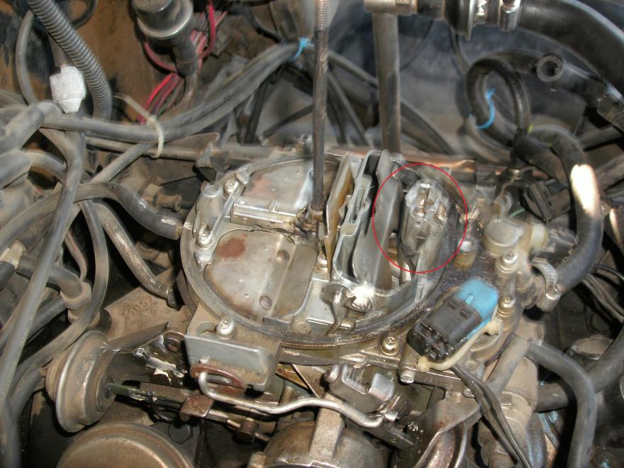

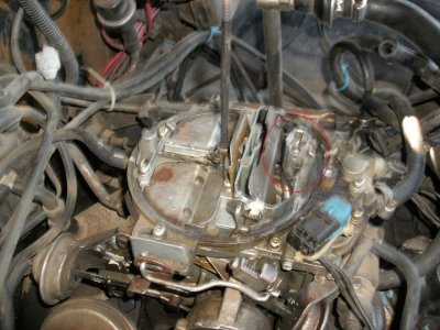

You mean this?
If that is what you are referring too it looks like the linkage that keeps the secondary flaps (I think they are called air valves) from opening when the choke is on. The air mixture screws are actually encased in the base plate. To get to them you have to drill a couple holes and knock the plugs out with a hammer and punch, once exposed there is a special adjusting tool that fits the idle mixture screws. If you feel like giving the rebuild a shot let me know and I will explain the bit I learned from doing mine twice.

You mean this?
No.. it's above that..in that picture you can see the choke flap is open, on my primaries... its that little deal right in front of them... if you were standing directly in front of the truck... there's a screw in there...and the screwhead is facing directly upwards.... wish i could do that red circle thing you did.. how do you do that?
I use paint for the circles since its a simple program and I can do it quick.

I see what your talking about, no clue man. My Q-jet did not have one.

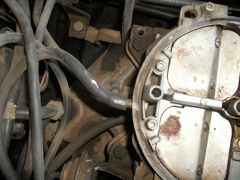

This is one of the screws i was asking about:
