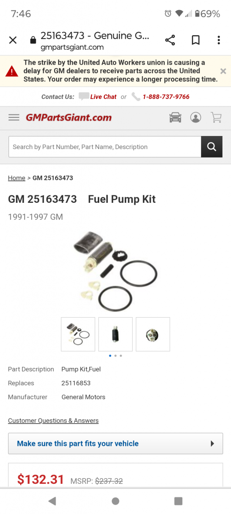

Quick search netted several of the local parts stores have them. O Reilly, Car quest, AutoZone. Looks like the average $$ is around $120. Apparently the Union strike is hurting availability. Lol
I'll stop by the stores and see if they can order it. Advance let me put it in the cart for $82 so I'll start there.
