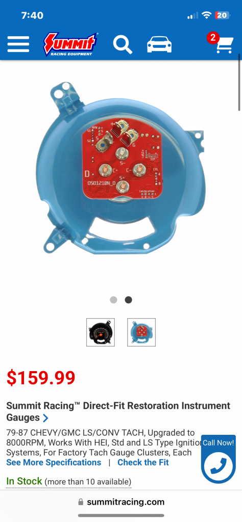

Hey Alex, when I did that conversion I used the LMC tach kit.
I could be wrong, and I don’t know if Summit includes any provisions for just swapping in a tachometer, but I think it generally requires a new printed circuit, and also the green plastic backing plate that has a space for the tachometer plug to sneak through the back to actually get to the tachometer. Apologies for the poor photo, but the LMC kit is pretty seamless and includes everything you need. Although, it will come with the stock tachometer that goes to 5k RPM.
The summit tach is 3 wires off back of the guage. Ground power and signal wire. Other post on here used an inline fuse that plugged into your guage fuse panel and kept the original fuse also. And used the wire off the 2nd fuse to power the tach. Signal wire obviously goes to the distributor. So should not be to hard to get tach going. Main thing will be the wiring for the fuel guage from oem location to the clock location.
You’re likely onto something there- I’m a little rusty since I did mine probably a couple years ago.
