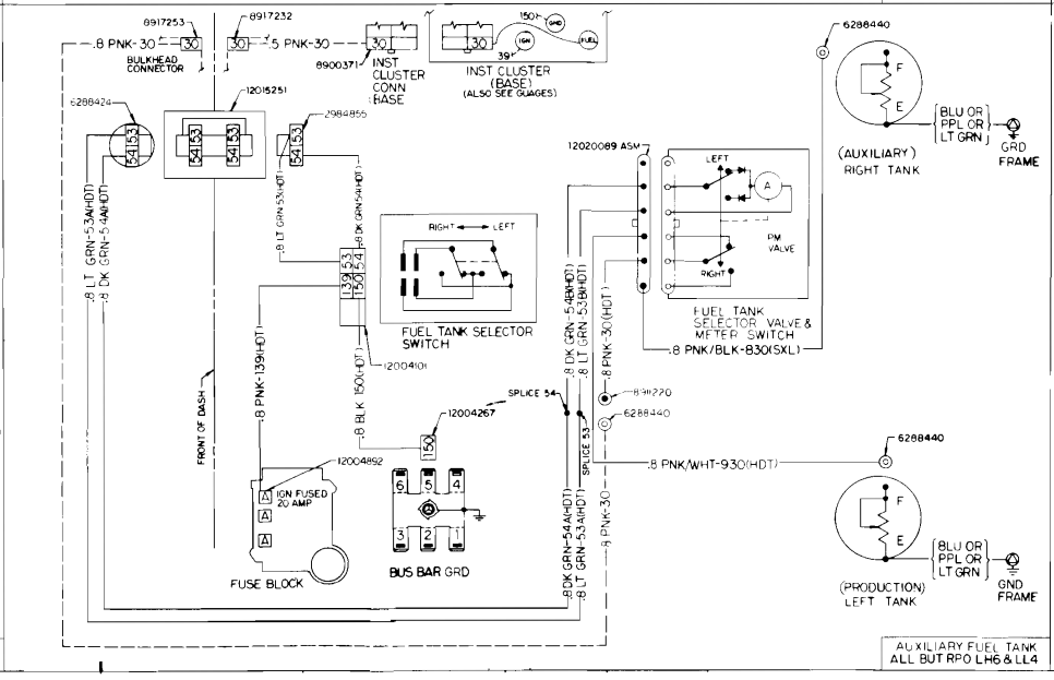

Fuel gauge at 9 all the time or only with passenger tank?
The pink/black stripe wire is not carrying any resistance up to the gauge.
Usually PNK/BLK goes to valve (from passenger tank sender) and from valve the PNK goes to gauge.
edited to include wiring diagram-just in case.

Can you pull the plug and jump a green wire from tank sending unit to the pink wire running up to the dash to see?
PNK/BLK or PNK/WHT (depending which tank you are checking) could be jumped directly to the PNK wire.
The sender controls the current going to ground. The more current going to ground the more the gauge heads towards “Empty”. Unplugging the PNK wire completely should send the gauge past full (3 o’clock)
