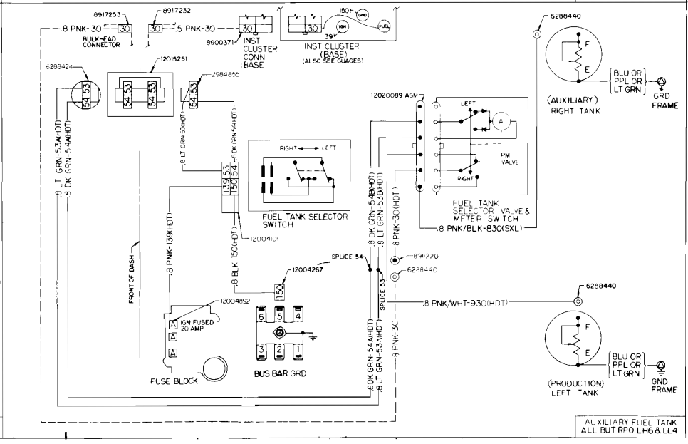

Someone correct me if I'm wrong.
In a dual tank setup the sender wire runs through the selector valve. Just something else to be aware of once you start troubleshooting where something could be wrong.
Technically it depends on the year of the truck. By 82' yes they ran though the selector valve, earlier trucks the gauge wire went though the switch in the cab. It's not common for the valves to fail in that way, but if he grounds it out and his gauge reads E it's most certainly a sending unit or grounding issue, if he grounds it out and there is no gauge responce then it's something "up stream" from that.
