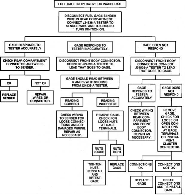

Check the pink wire. It runs from the dash, through the firewall, along the frame rail and attaches to the sender head.
Look for breaks in the insulation which might indicate a intermitent connection within the wire. A broken/loose connection on the hot wire (pink) will peg the gas gauge to FULL. Just like a bad ground wire between the sender head and frame will.
With the gas gauge, higher current flow through the sensing circuit (pink wire, variable resisitance sender unit & ground from sender to frame) will drive the needle down.
If anything slows this flow the needle will move towards FULL. If the circuit is completely broken, the needle pegs HIGH.
The diagnostic chart:
BTW - was the truck ever equipped with a dual tank set up?
