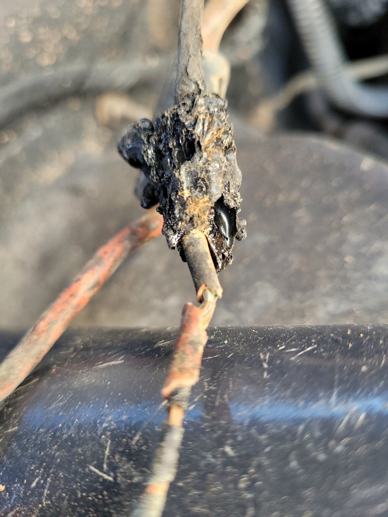

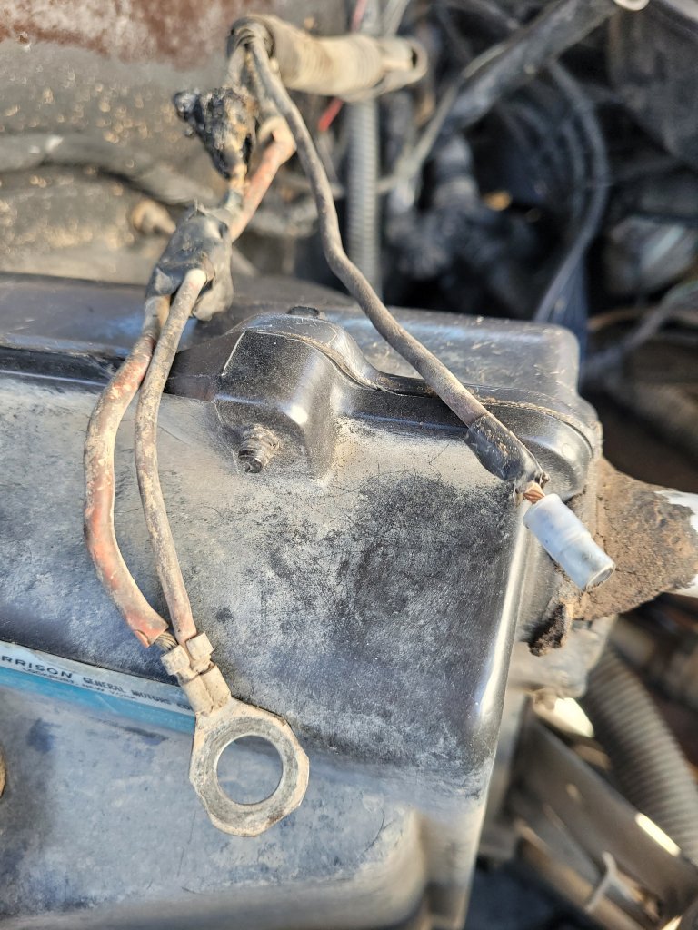

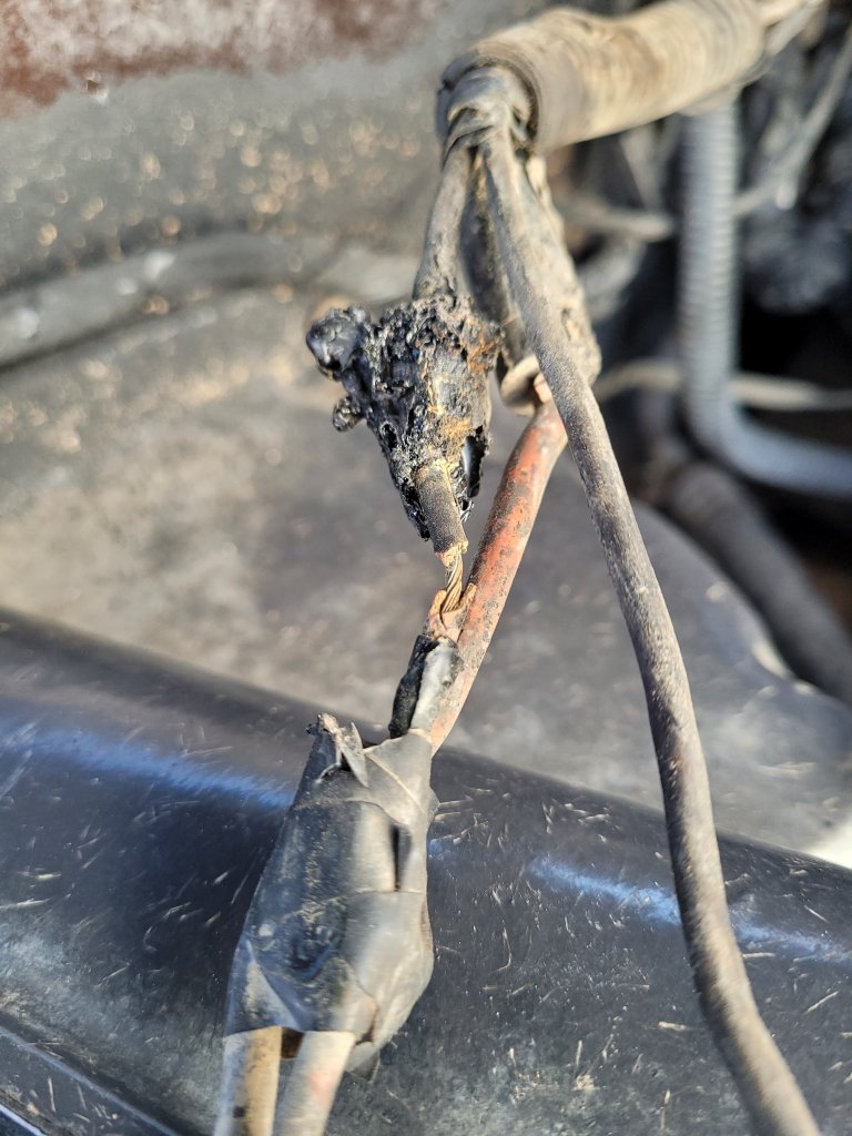

My son's truck (1987 GMC V1500 350ci tbi) has only one fuel relay on the firewall. It has a short wire with connector for testing the pumps. I read all about the replays before I worked on my son's truck on this site, but I can't remember the details about second relay. The information is on this site somewhere.

Hopefully your starter wires look better than this. This is one of the causes of my son's truck having intermittent stalling and starting issues. The engineer who decided to put the main electrical connection on the starter is not my favorite person. For some reason a previous owner bypassed the blue wire and ran a new one, found that when I opened up the wiring loom to the starter and it had wires and colors not on the wiring diagrams. i am guessing PO bypassed the cut-off relay to the fuel tanks instead of finding and fixing the problem.
The truck actually ran with the fusible link toasted, just not as often as my son would like. lol
