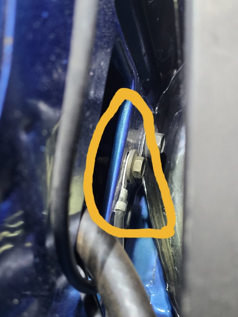

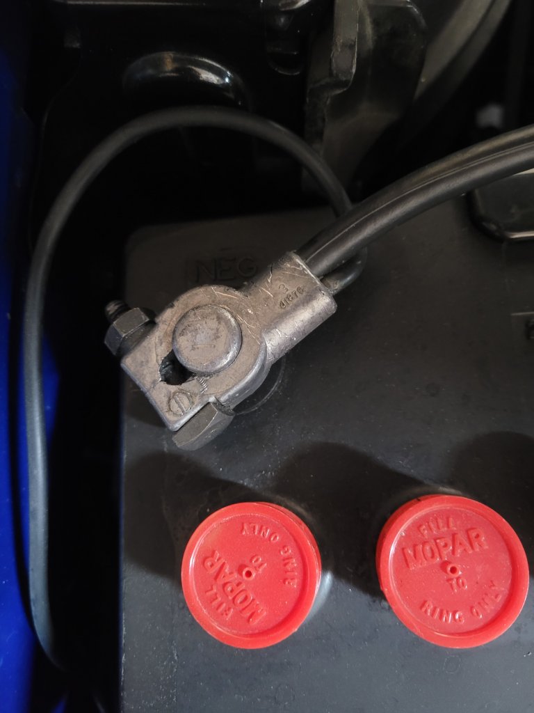

Curious is there any diagram that shows where all the grounds are on the entire truck? Without all the other wiring in the diagram lol. I know what the ground symbol looks like on a diagram if I have to use that but to simplify or speed up the process I was wondering if there is one just for the grounds? Is there such a thing. If not maybe I will do it one day.

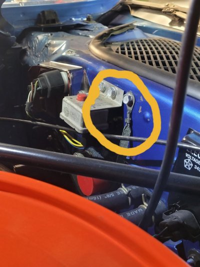

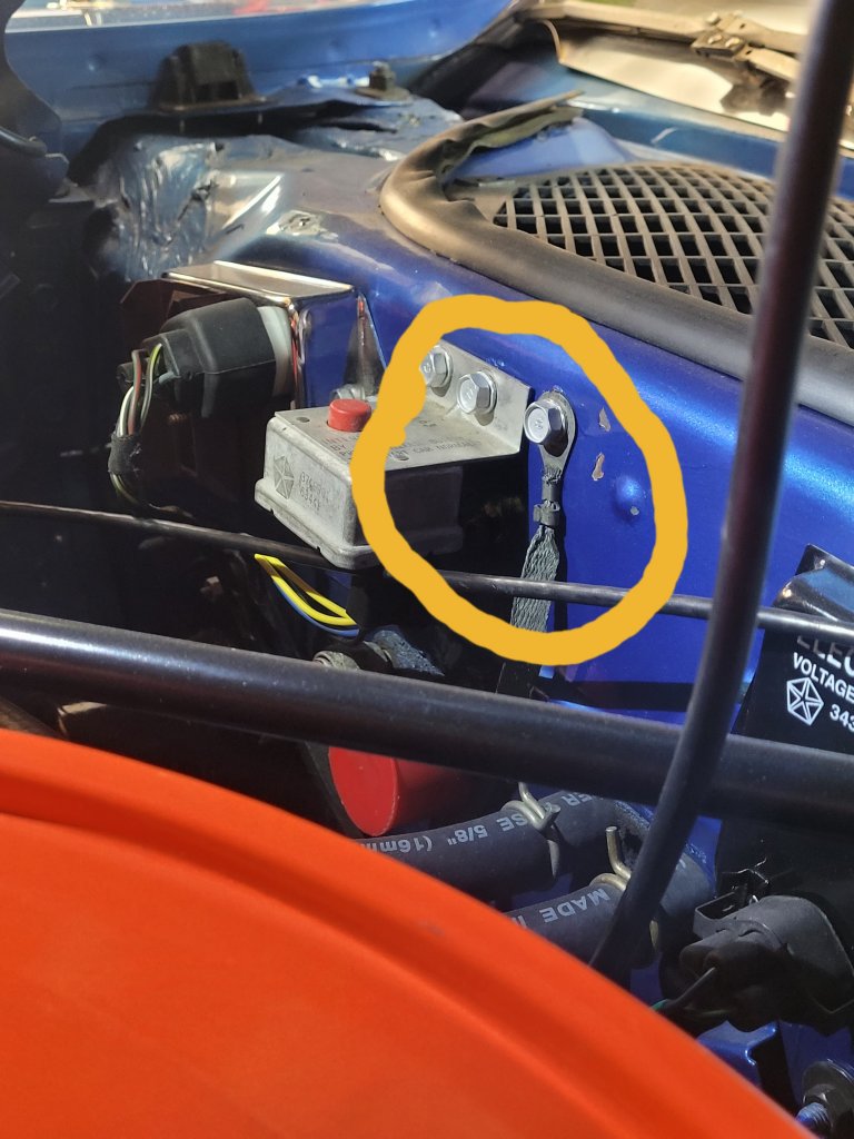

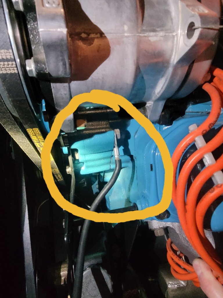

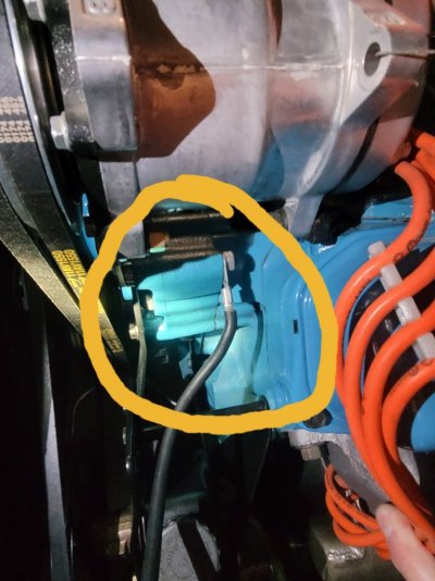

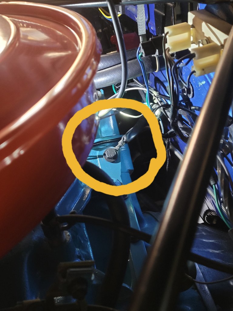

The main grounds are simple, you have the fat ground cable from the negative battery post going to the front of the motor (attached to head or block) the negative cable should have a second smaller wire going to the chassis of the truck, attached somewhere close to the battery. Then you should have another ground wire going from the back of the engine to the firewall. If the bed on the truck has rubber between the mounts for isolation it will also have a ground strap from the bed to the frame. (if the grounds connect to the frame and not the bed it may not need the ground strap from bed to frame.
The secondary grounds are all close to components. the tail light will have a ground close by, the headlights are grounded close by, probably to the radiator support. The dash with have multiple grounds near the e-brake assembly. Most vehicles from that era also have a ground from the steering column to the dash.
Sorry the pictures are grounds on my Charger and not truck, I can post pics tomorrow when my son comes over with his 87 GMC.
