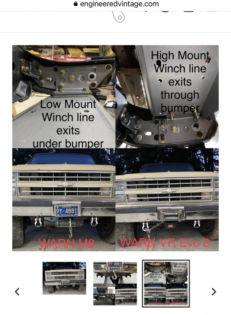

Well I am resurrecting this one from the dead. I have settled on a front winch mount and was looking at the behind bumper winch mount (bbwm). Does anyone have this setup?
Bextreme04
Supporting Member Army
May 13, 2019
4,826
6,530
350-4bbl
I have their front shackle hook mounts on mine. I'd also eventually like to get the behind the bumper one. My experience with them has been top notch. Excellent quality parts and the guy is super responsive. I think he's in Gresham
