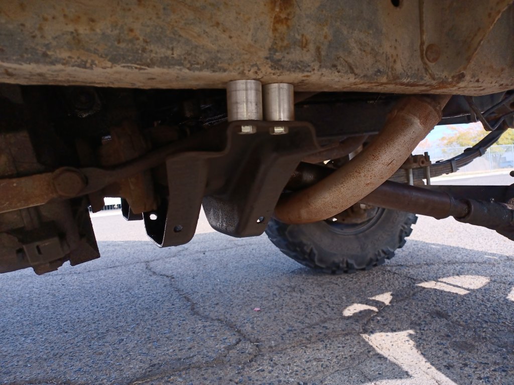

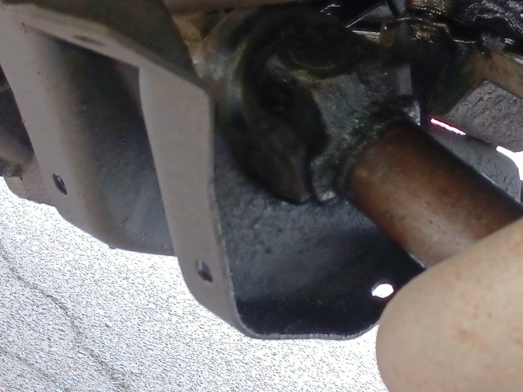

Look his cross member already has the spacers in between the frame and unit.
It also appears the rubbers are rotten and maybe that is allowing the the tail end to droop enough for contact.
Hey man I have the same problem going on but I got the spacer on it already and still hitting

Thanks. It's one of those cases where seen that-done that so it sticks with you. Driveline vibration that suddenly shows up... as the rubber gives up the ghost the tranny/TC slowly settles and one day starts to vibrate.

Good golly, that's a lot of t-case drop. I think there's two things going on. First, the trans is angled so far down that the t-case is low hanging fruit. Second, the trans mount may be completely shot... or rigged.
