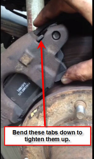

easy fix!

Didnt know they were bendable...thought they were cast iron. I'll give it a try Geo. Thanks!

That took care of the problem. Now I feel stupid...lol. Thanks again George.
