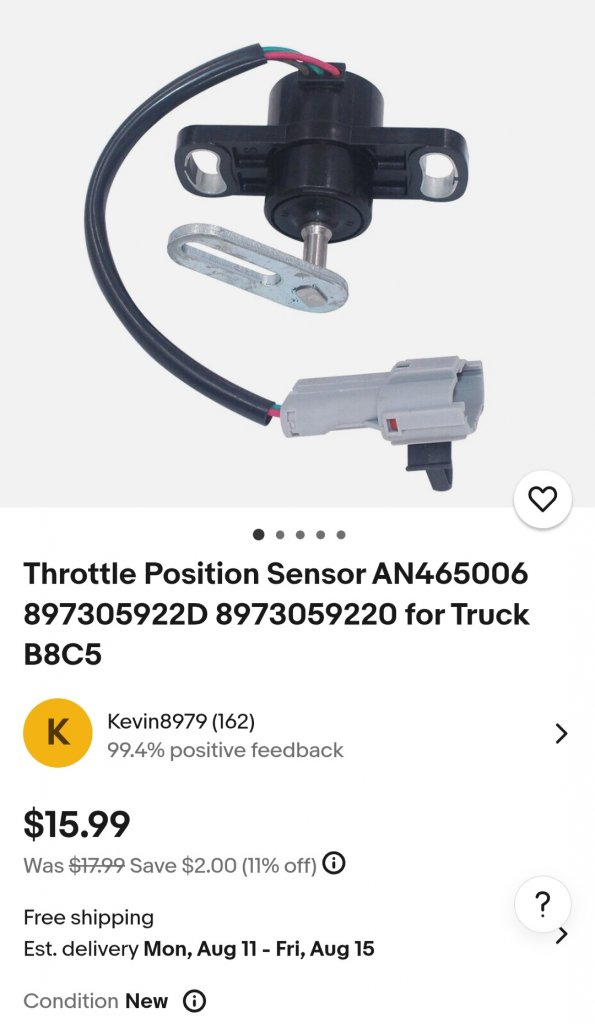

I have gotten roped into a project I never would have started,but non the less I am in it now. It is going to need a custom TPS,I've seen several different universals. I stumbled across this Isuzu TPS. Looks to me like I can make a mounting bracket,attach a cable to the throttle linkage and this tps without much trouble. By moving the cable position up or down in the slot I can control ratio so I don't bottom the switch at full throttle or Idle. Just throwing this out there for anyone needing a TPS for a transmission controller. I'm going to experiment with this cheapy,then purchase a good one after the details are worked out.

I have gotten roped into a project I never would have started,but non the less I am in it now. It is going to need a custom TPS,I've seen several different universal. I stumbled across this Isuzu TPS. Looks to me like I can make a mounting bracket,attach a cable to the throttle linkage and this tps without much trouble. By moving the cable position up or down in the slot I can control ratio so I don't bottom the switch at full throttle or Idle. Just throwing this out there for anyone needing a TPS for a transmission controller. I'm going to experiment with this cheapy,then purchase a good one after the details are worked out.
i think it would depend on if its a progressive or linear throttle on your engine to begin with
