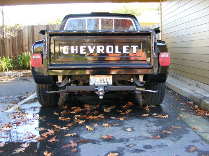

I am not sure about your year, but my 77 step side does not have any bed cross member in the way of lowering shackles. My shackles clear the bed floor by maybe 3/8 inch.

My stepside has a bed crossmember in the way too. Is yours a long bed? Or have 56" rear springs maybe?
no its a stock configured 1977 short box step side. I have no idea on the spring length but it is a factory 454 C/10. I will post a picture of the shackles tomorrow. if I can figure out how on this forum.

That's a very nice truck! Being a 454 truck from the factory, it probably has the longer (56" rather than 52") springs, which I was not sure if the factory ever used on a short bed truck. But I guess they did! Cause I'm pretty sure your rear spring hangers are further back on the frame than mine, judging by your bumper-less picture.

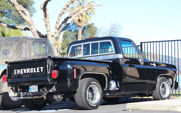

Thanks! You may be right. When I was swapping the shackles, I had this nagging feeling something was a bit different. See I worked for GM back in the day when these trucks were still fairly new. Both as a line mechanic and a parts manager. and I don't recall the rear spring hangers being just a few inches away from the ends of the frame rails. But that was also 35 years ago and my memory is not perfect anymore. I wish I had my old parts manuals for these now. I know the history of my truck. I am the 2nd owner also the build sheet is still in the glove box.

You can easily tell if you have 56in or 52in leads by the position of the rear hanger as you seem to have noticed. The shackle hanger is behind the rear crossmember with 56in leafs and in front of the rear crossmember with 52in leafs.
