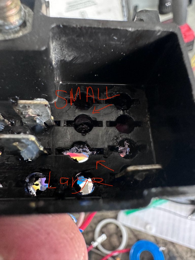

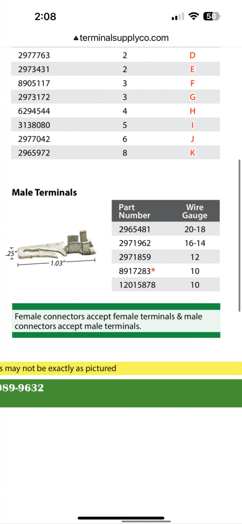

Im rebuilding my trucks engine harness. In doing so i accuired new pins for the wires (297-1962) delphi brand. Further i dove into the connector i come to realize 2 of the pins are larger then the others. The 2 larger goes to 12v supply and coil+. I ordered 12 gauge pins but are same size. The pins im looking for are about 1/8 inch wider then the rest. Small pins wont fit in large pin location. I will attach photos of catalogs ive found with part numbers. But the larger pins are not on it. Any help is appreciated.

Series 59 male terminals. American Autowire carries them, I think the Electrical Depot and Mosier has them as well.
Those are both main power feeds from the heavy red wires that go down to the starter.
inspect your headlight plugs, series 59 female are in those sockets. Now would be the time to replace them if needed.
