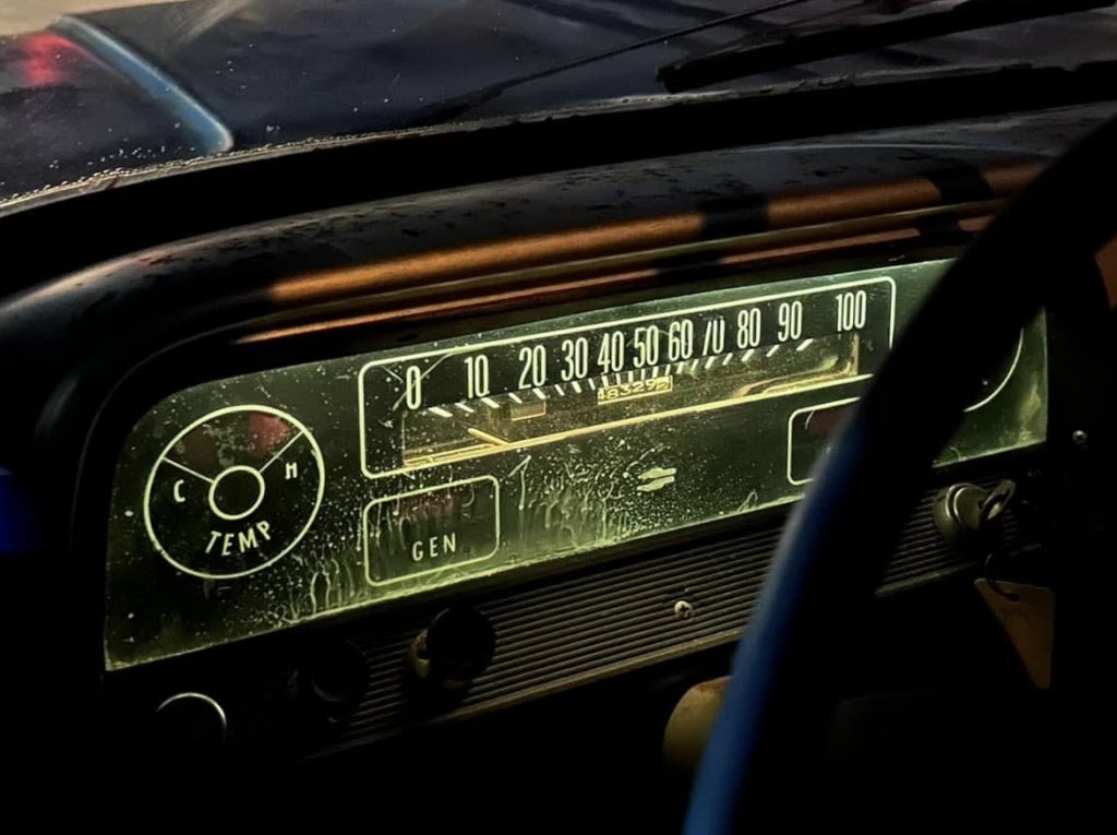

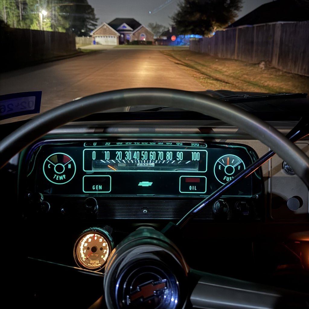

Some pictures

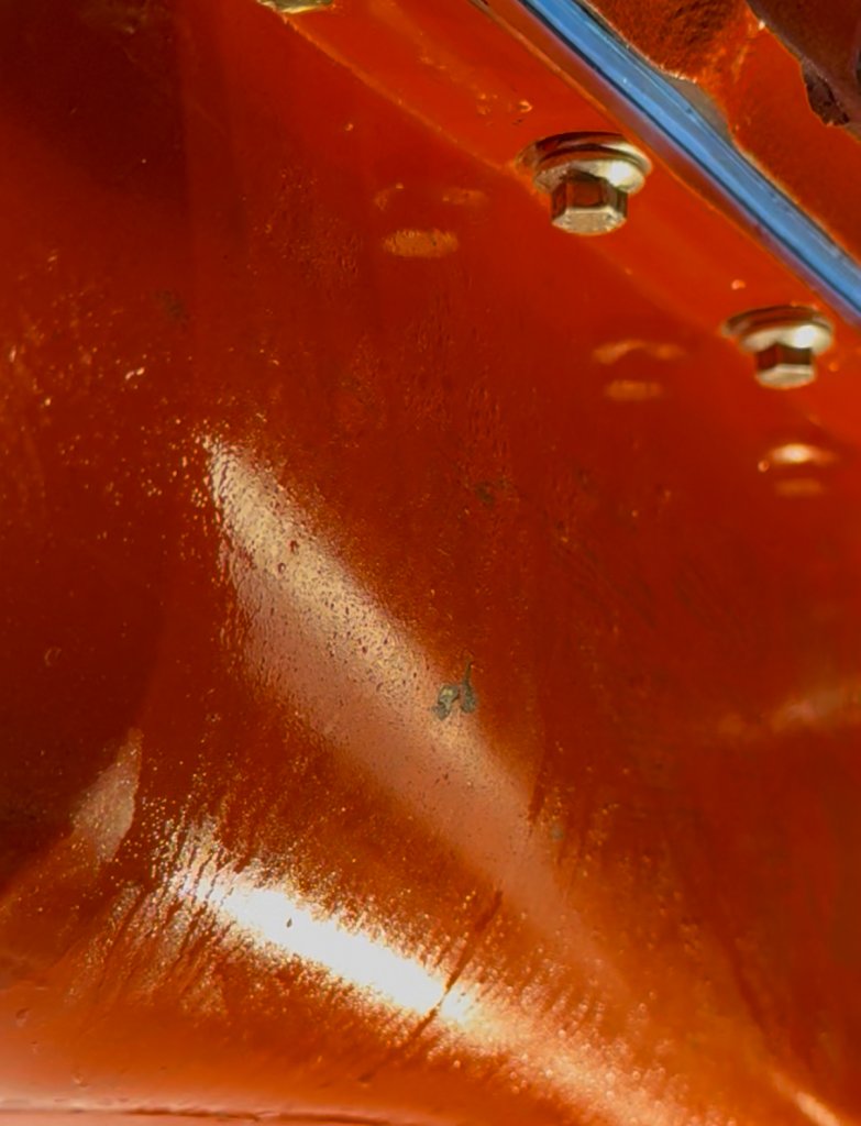

The emotional rollercoaster this truck is taking me on is diabolical. Drove the truck 20 minutes away, got it up to 65 for probably 10 minutes of that 40 min trip, came home and leaking all sorts of oil. Looked like it was coming from the dampener seal again but not like before, it was just stationary not actively dripping. Started looking elsewhere and the entire pan looks like it 'sweat' oil. Started looking and it really looked like it could have come from the flat surfaces of the pan gasket. So i cleaned it all off, got the torque wrench out, it didnt go down to 12 lbs, so I got the inch lbs wrench out and converted.
Even though I though I probably overtightened the pan bolts causing a leak, turns out I didn't tighten them enough. Took it on another trip, and just drove it to get pizza, pan still dry.

Hopefully that’s fixed

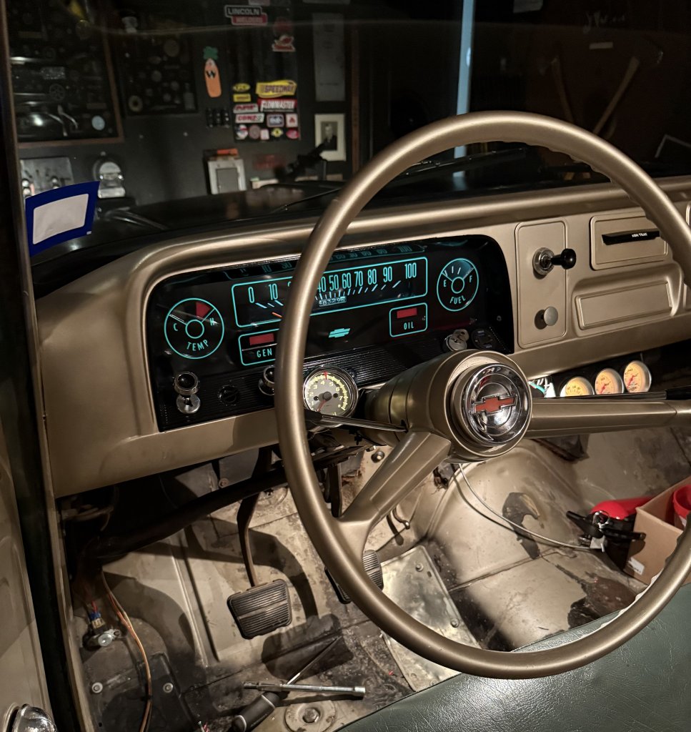

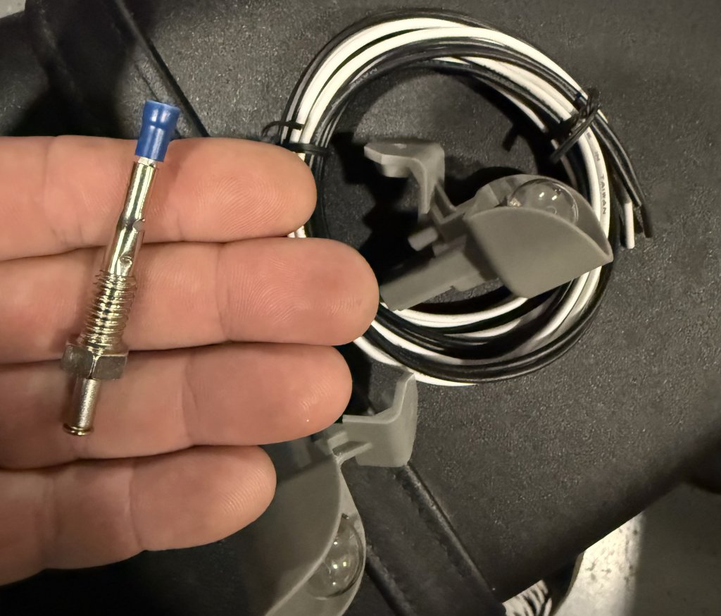

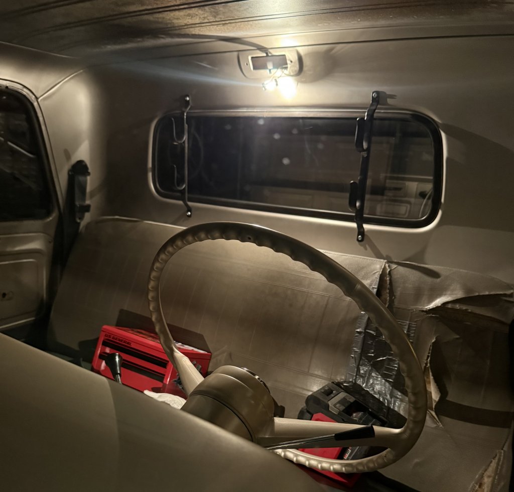

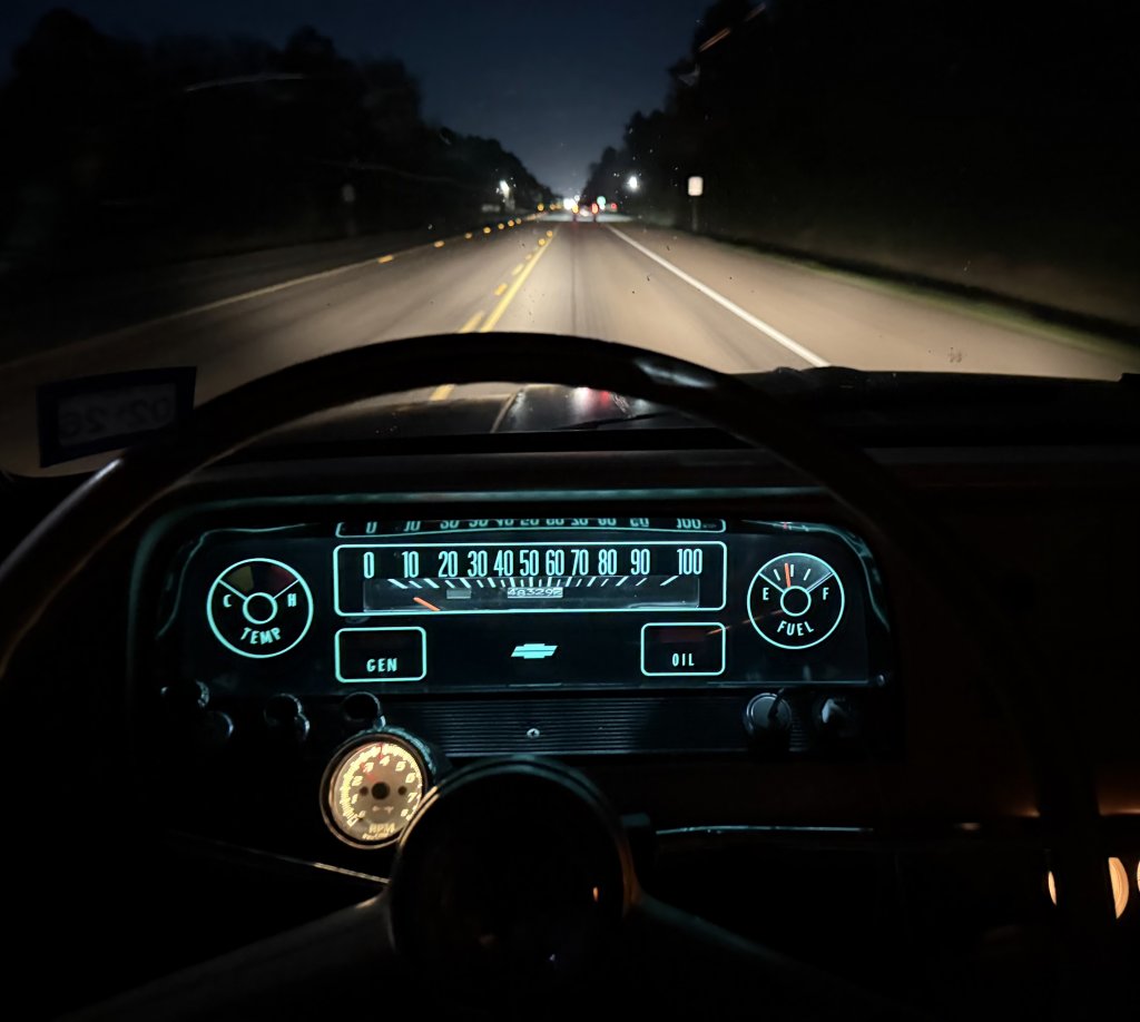

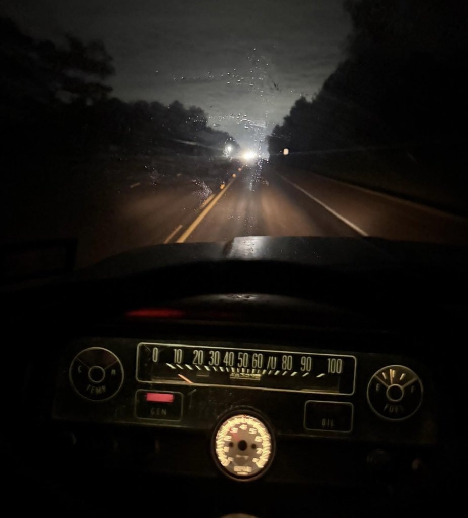

Got door switches and under dash lights installed. Works great, got the dome on them too. I wouldn't buy the LMC kit though, the door switches are kind of cheap and they flatten the threads out when you screw them in. They are supposed to cut their own threads, and they do but it ruins the threads on the switch so I wrapped some tin foil on them and put them back in, holding pretty good. I'd source factory switches from a squarebody or something if I did it again. These little additions are what makes a vehicle a joy to drive
Hi/lo switch on the floorboard **** the bed, got a new one to install today. Whole damn truck is going to be new soon.
No more oil leaks as of right now, drove the truck to the gym today 65 mph and back, no leaks, not even valve covers
Replaced the thermostat yesterday cause I suspected it was stuck open (it wasn't) because the truck takes FOREVER to warm up in 45 degree weather. (ran 10 minutes at idle and stayed at 130 on the new gauge). Since I had it out I went ahead and put the new one in.
Today, noticed the coolant temp fluctuating 10/15 degrees back and forth while at highway speeds, assumed there was air in the system. Jacked the front up as far as I could get it, let it run without cap on, squeezed hoses, didn't see the level drop so IDK. Even half unscrewed the plug in the t stat housing with engine off to see if air could come out. I'm sure its fine, I'll check it again when I drive it tomorrow.
Sure is nice driving the truck with the new dash work, especially at night. Makes the 3 on the tree not so bad

Floorboard and dome lights on door switches

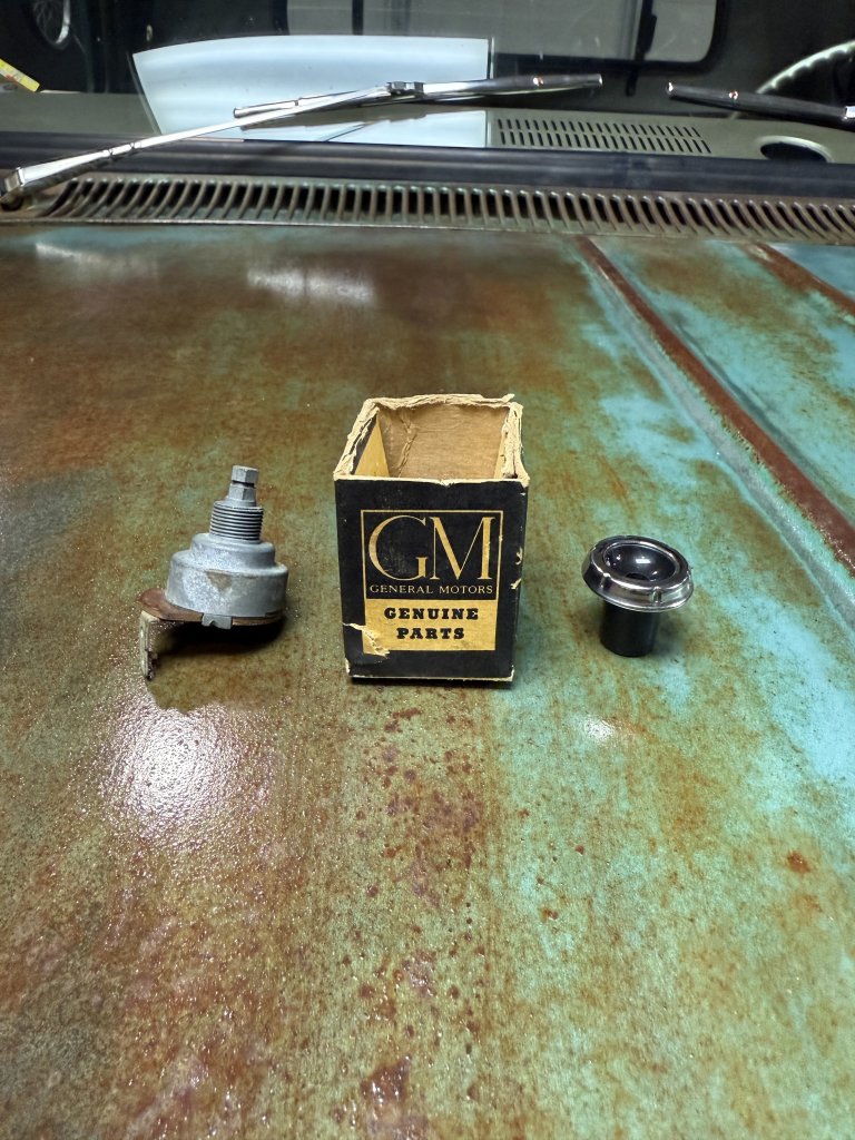

5 hour roadtrip today, not ONE oil drip on the garage floor afterwards
NOS wiper switch came in, works as it should

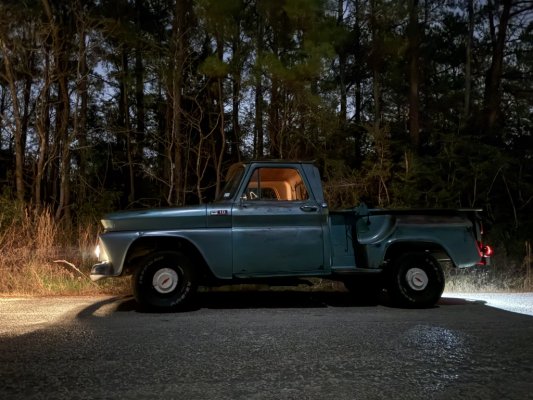

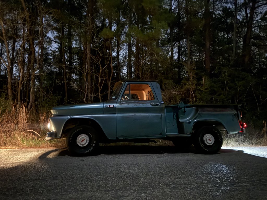

A before and after of aiming the headlights, fixing a ground issue and the dash. They are the same headlights.
