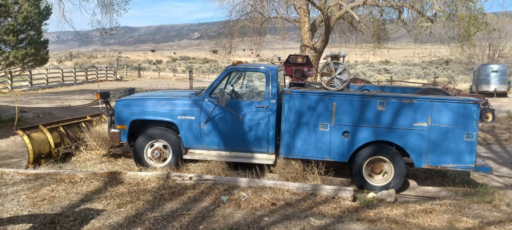

Found on a farm. 89 Chevy Scottsdale 1ton 4x4 454 tbi w/aftermarket propane system SM465 NP 205. 2 owners, ~80k on the dial. Not running...yet. Been sitting +10 yrs according to farmer. So far engine cranked on a fresh battery, no fire unless fuel poured down the TBI, strong/smooth response to fuel. Power at pumps in both tanks. No pump noises even on bypass. So far all electrical systems, clutch/trans/transfer case/hubs all work. I filled a yard size trash can twice with junk from under the seat and out of the toolbox. Dash is toast, rubber floor mat in same condition. A perfect seat underneath 2 saddle blanket style seat covers. All glass crack free, little bit of rust cancer in cab/fender corners and bottom of tool box bins. Once I get that fuel flowing I'll have more.

Great find! I'd trade my work truck for that in a heartbeat.
Welcome aboard, hope to see more of this truck!

Nice find. A V truck is a gem these days, running or not. If all the accessories work on the utility bed, that's an added bonus.

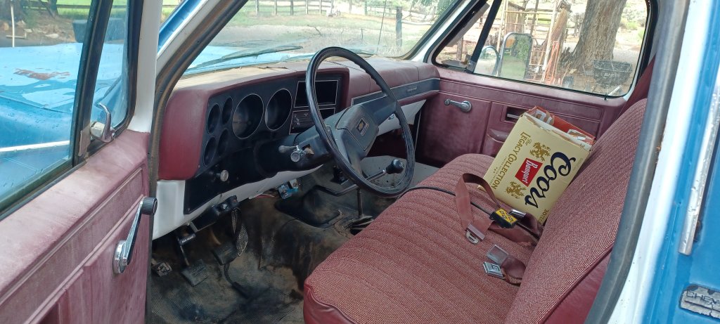

This evening while having my happy hour, I did realize the driver's side seat belt was inop. I disassembled the retractors, cleaned everything up and re-spooled the retractor springs and now everything works like a charm. Maybe I'll do up the others ideas tomorrow. Here's an inside peek into what I've initially started calling Babe. As in the big blue ox.

Interesting. From the look of the lower dash, It looks like it was a white truck that was painted blue at some point. It's also nice to know I'm not the only one drinking Coors Banquets when I work on my stuff.
