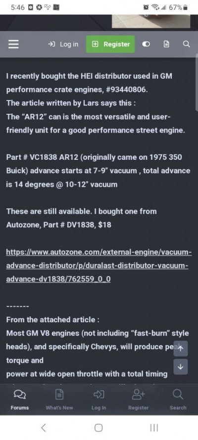

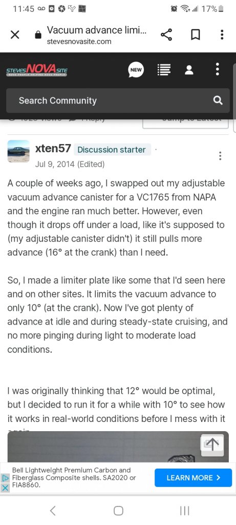

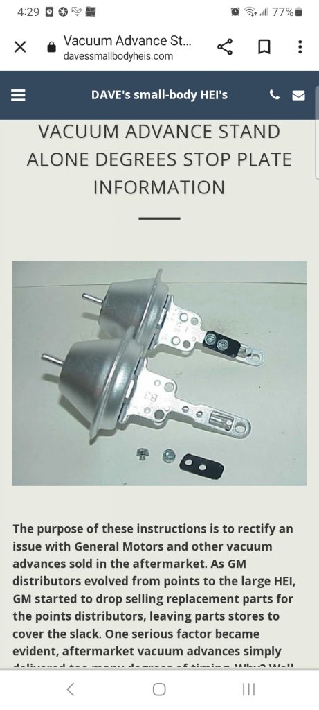

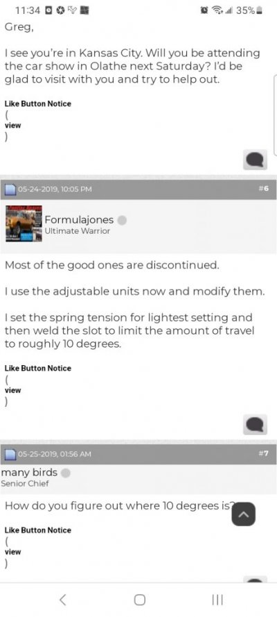

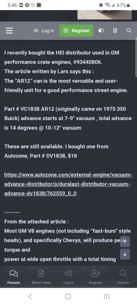

@SirRobyn0 I had an absolutely worthless conversation with standard motor parts tech. Trying to get some advance specs. An even more worthless conversation with MSD who when tech 1 couldn't answer transferred me to tech 2,about then I figured I should put in a job app. there. Anyway back when I was telling you to try to find a factory advance with the correct hg specs. and make a limiter so advance would drop out so you could run more advance and not ping. In my search for specs today I came across these. Take a look you might be able to get some more timing.
Your absolutely right, without a doubt a limiter combined with a better vac advance can, would likely be better. Heck I still have the original can from my original distributor I could use and limit. But at the time I needed to use the truck and I had the adjustable can on hand, and it's working well enough that I haven't made the time to tinker with it further.
10,175
19,672

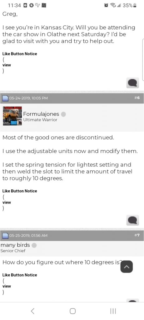

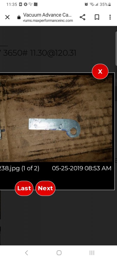

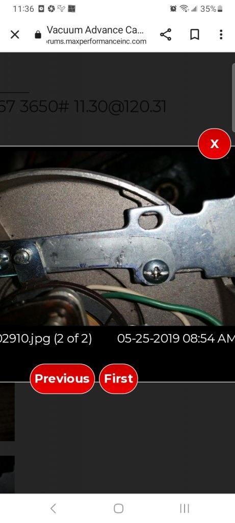

I'm still researching for me but good news for you. If you make a stop plate like the pic I ll put up make it so screwed down it touches the pin,remove I don't remember the amount I'll get it for you from the end of the plate that will limit vacuum advance so you can set your adjustable at a looser setting. .125 = 10* .135= 12* I think I'm going to try that buick can it has a strong following .
