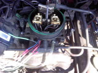

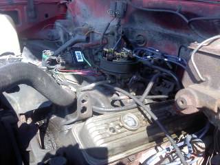

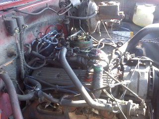

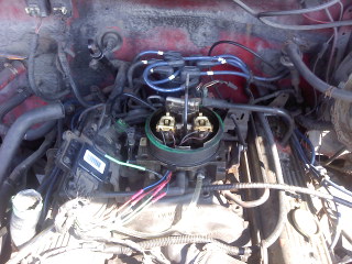

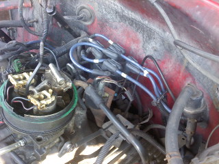

Can you post a pic of the top of your engine close up, no air cleaner?

here are some pics its not the orginal #s matching but its same size engine

Is your charcoal canister on the pass side? :wtf:

Does it run fine when it is running normally? I.E. not sputtering? Plug wiring at the cap looks off to me for some reason in the 3rd pic. Unless that's a crab cap.

Looks prettybgood to me. Just one thing...make sure the Green and white injector wires are going to the drivers side injector...I see you had to splice in new plugs...I had to do the same thing.
ya runs fine and the wiring is right unless u go by what chilton says and every wire should be moved back one which wont work for this truck
ya the green and white wires go to the driver side injector hope fully she is fixed for good
You can run the wires across the cap on a TBI distributor, no coils in the way. I dont like to do it, because there is a chance that spark could leak from one of the other posts, and cause problems...I prefer out and around.
Where is that clear vacuum line on the front of the TBI running too?
Thats going to the vac port on his AIR diverter valve...Thats the valve I need.
