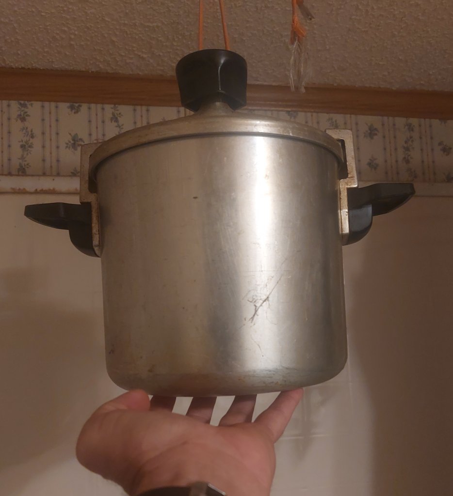

I don't need one I've had a purchased from the tool truck one for 30 years. But someone on here said they made one,I don't remember who or how. But if I needed one I'd buy a pressure cooker from a thrift store drill the bottom for a fitting 1 nut inside 1 nut outside 1 sealing washer inside. Put your hose for the oil galley there, remove the existing pressure valve put your air pressure there. Use some common senseIf you can't use common sense leave the pressure relief and just drill for an air fitting.

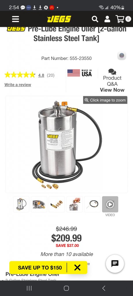

Yep but that only works for SBC air over oil works on everything. I'm talking this basically but a pressure cooker as the tank and the hose out the bottom because that's dirt simple. You could run it out the top but that would require a dip tube and a compression fitting. Put an air in the top,and a pressurized oil fitting the bottom.

FWIW the summit will work on buick, amc, pontiac, sbc, bbc and more.. ford uses a hex shaft so tap a socket to any extention and bingo..
I know nothing of mopar.
Anywhooo,, run a 1/2 drill, build 50+ psi easy rotate crank 90. Rinse and repeat
a pressure cooker with the potential to get above 15 psi scares the hell outta me, best case it's a giant mess, i wouldn't let it get near shop air, a bicycle pump with a gauge and a long enough hose to stand on the other side of the truck would be the only way i'd go near a bomb like that
