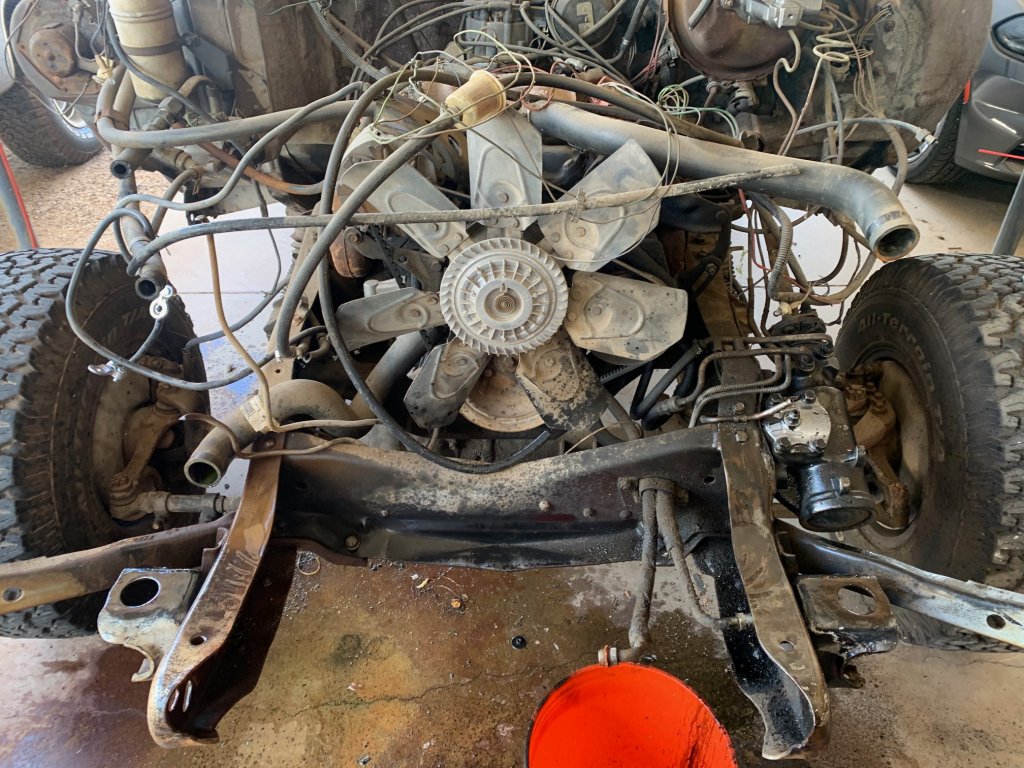

Does anyone know if there is a more efficient blade design for a clutch fan? I was watching some YouTube about that and there is a definite HP draw on some of the old school fan designs. I have a 7 blade OEM I pulled out yesterday, cleaned up and will go with but before I do Id like to see what ya'll think.
MK
I think you should stick with the factory 7 blade. Is there a HP draw sure, but most of that is going to be when the fan clutch is locked up and that thing is sucking tons of air though the radiator which is exactly what you want when it's hot out. When the fan clutch is disengaged there is little HP loss. My 2 cents run the 7 blade fan. Make sure your fan clutch operates properly and engages and disengages as it should. A severe duty fan clutch will pull the most air when locked up, heavy duty will be similar, possibly a little less and a standard duty will only pull about 65% of the air, a serve duty will. BUT when it's hot it'll have to stay engaged longer and more often to keep temps where they need to be. Thats what I've got. I'd run the 7 blade with severe duty clutch and not think twice about it.

I have run my Olds at the track both without the thermal fan clutch, and with it installed. These were back to back tests, there was no difference in mph or E.T. The ******** stories people have about mechanical fans taking lots of power is exactly what I said, pure ********.
A thermal fan clutch might pull some power when it’s engaged, but unless your cooling system is so marginal that the engine is close to overheating all the time you will hardly notice the fan.

Its not pure BS. It does take power to turn the fan. Empirical data from a dyno on engine masters showed that it can be as much as 40hp drag at full engagement(i.e. no clutch). In a racing instance or driving on the highway where you are moving enough air through the radiator without the clutch engaged, you are probably drawing next to nothing. The clutch spins at ~10-20% of engine RPM when not engaged, which is not a linear relationship to HP. 20% of 40hp is still only 8hp. I would bet that 10-20% rpm only requires maybe 2% of the same power to turn the fan as it does at high RPM, which works out to 1hp or less to turn the clutch fan when it isn't engaged. When it does engage, at high RPM, you are going to start to feel it pretty quick.

I have seen that episode.
When engaged, they do draw some power. But most people don’t try to race with the engine hot enough to cause the clutch to engage.
As I said, I have run my car with and without the fan and clutch, back to back on the same day. There was no difference, maybe a couple hundredths of a second. There would be a huge increase in ET, and loss of mph if the fan really took 40 hp.
