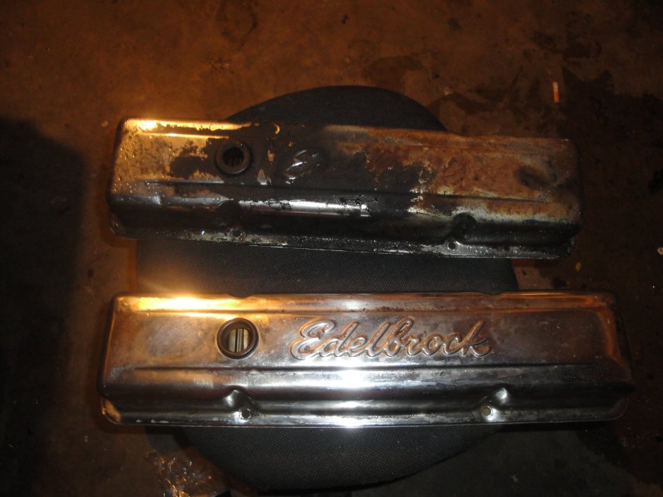

found them at a local pick and pull today and i picked them up for $8. i thought that was a really good price? i cleaned one up so far and i think theyll look nice on my truck, but ill need a new oil cap since i couldnt find the one for it anywhere near the truck.. could i order it from edlebrock?

Yeah, or get a press in Spectre oil cap from the local parts shop. Sand the gasket surfaces on those so they get some bite on the gaskets.

With the PCV in one cover, you will want a breather in the other cover and you just use the breather as your oil fill. You can use any breather designed for the larger grommet in aftermarket valve covers.
