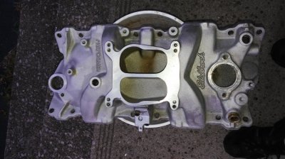

I got a hold of this intake for $50 from a coworker, it had clear powder coating on it that had turned brown and looked to be melted or been super hot enough to turn it dark brown. Anyhow I fixed that and am wanting to use it but I have a few questions about what carb to intake gasket I need and if I need an adapter plate etc. Also I am wanting to use new intake bolts and want to use the Alan headed bolts or the ones that have the 10/12 pt head on them. Anyone do something similar? Any other things I might need like different kick down cable mount, and such?

I'm pretty sure I have the same intake on mine.
I ~think~ it can fit both a spreadbore AND a squarebore carb, so if you want to run either Q-jet or Holley, you can.
I just used factory Q-jet gaskets, no adapter. Been running 3 years now, no problem.

Yep, it takes both types got one on my truck with a square bore carb.. You can use any bolts you want just make sure they're not too long so they don't bottom out before the intake is tight.

Yeah, I got my intake for free, because I had to TIG closed and re-drill and tap two holes from bolts that were too long.

Anyone have a part number for a base gasket? I'm sure I could find one when I take the carb off but I'd rather get the stuff before I tear it all apart

I made an 1/8" plate for mine didn't think just a gasket would work but I guess it does??, just ask for Q-Jet base gasket, you won't find a number on the gasket.

I like the 12pt socket head idea better than the allen head bolt idea myself. :shrug:
I'm assuming you're asking about gasket and adapter for using a Qjet? For that intake, I do believe it's turn key. Use your same gasket, no adpater, and your detent cable if a Th350 or TV cable if 700r4 should all be the same too.
