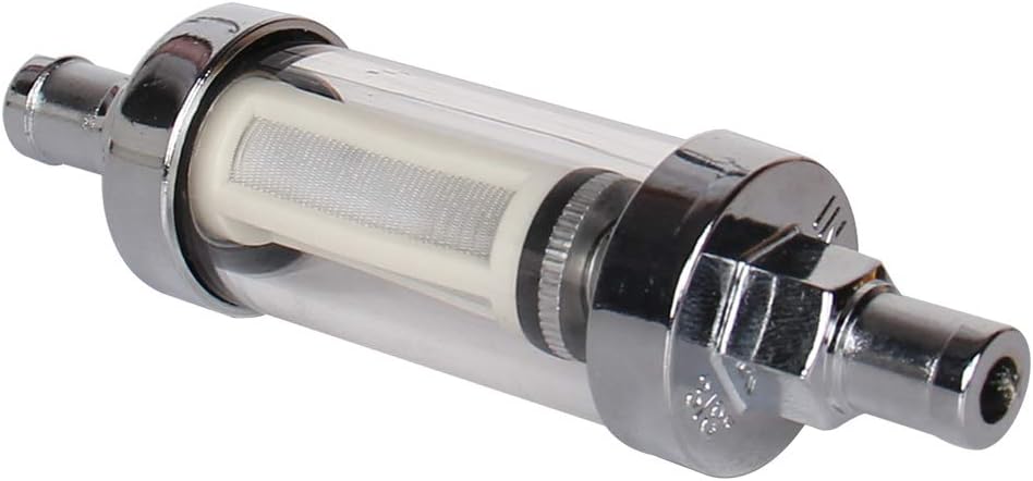

Wait a mechanical pump with a fuel regulator? Most stock style mechanical pumps won't make enough pressure to need regulated especially the 15 GPM auto part specials most places carry. I'm running an 80 GPM Edelbrock pump, and it only makes 6-7PSI Feeding duel AVS2s.
BTW those glass fuel filters are the cause of a lot of vehicles that look like your profile pic, would delete/replace with a metal or plastic one immediately.
I have several different types of fuel filters on the shelf, including the one you sent a link to. I only used the glass one because it was handy and I have a bunch of them. As for being a fire hazard, you might be right. I have it positioned in a way that it cant break by getting bounced around, but anything is possible. Maybe I will change it out though for something less breakable.
Throw them all away. They don't break and leak, they are just poorly manufactured and can suddenly start dumping fuel at any time.
