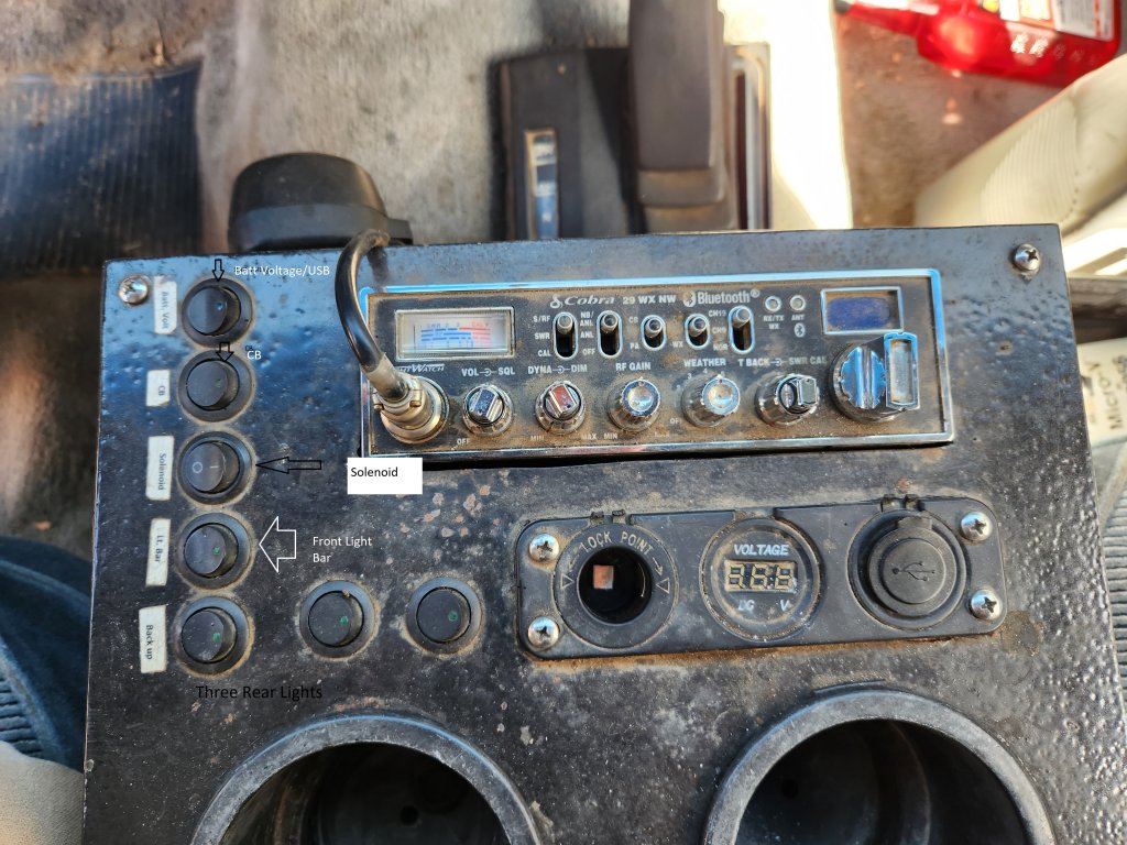

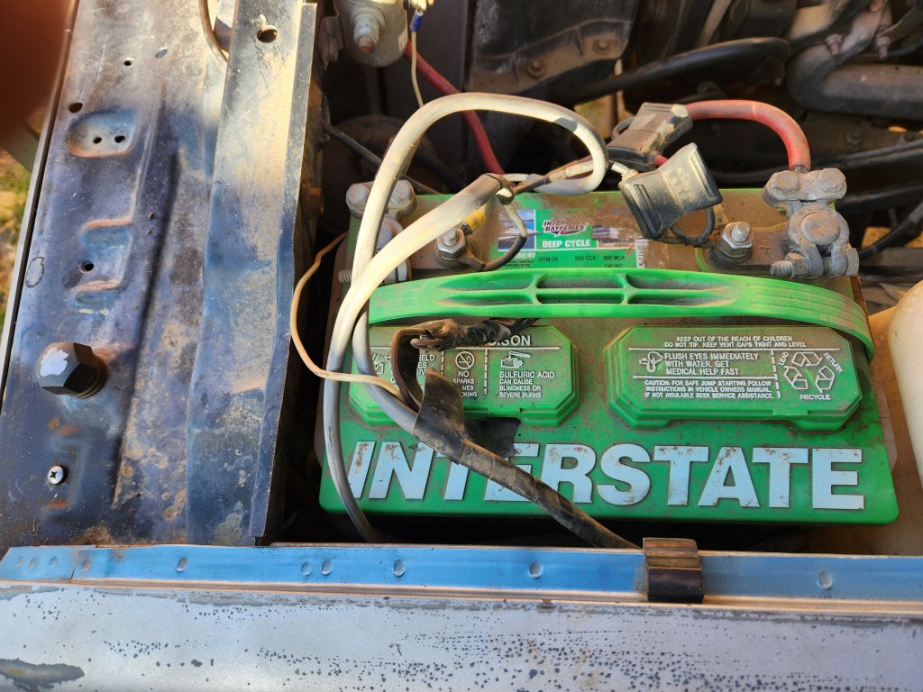

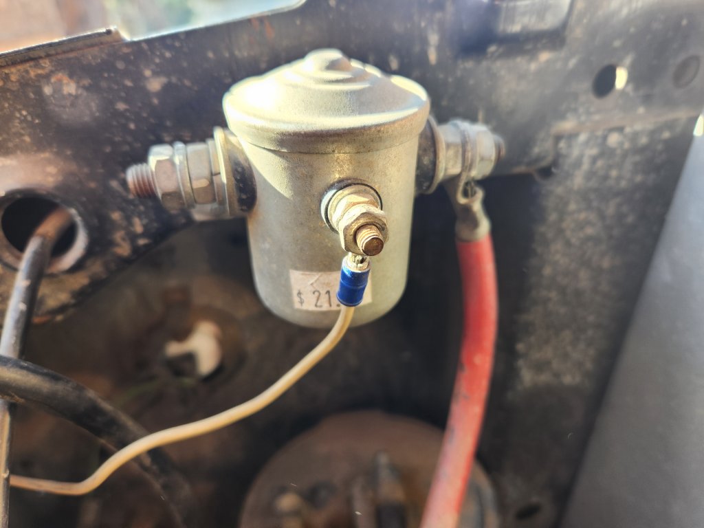

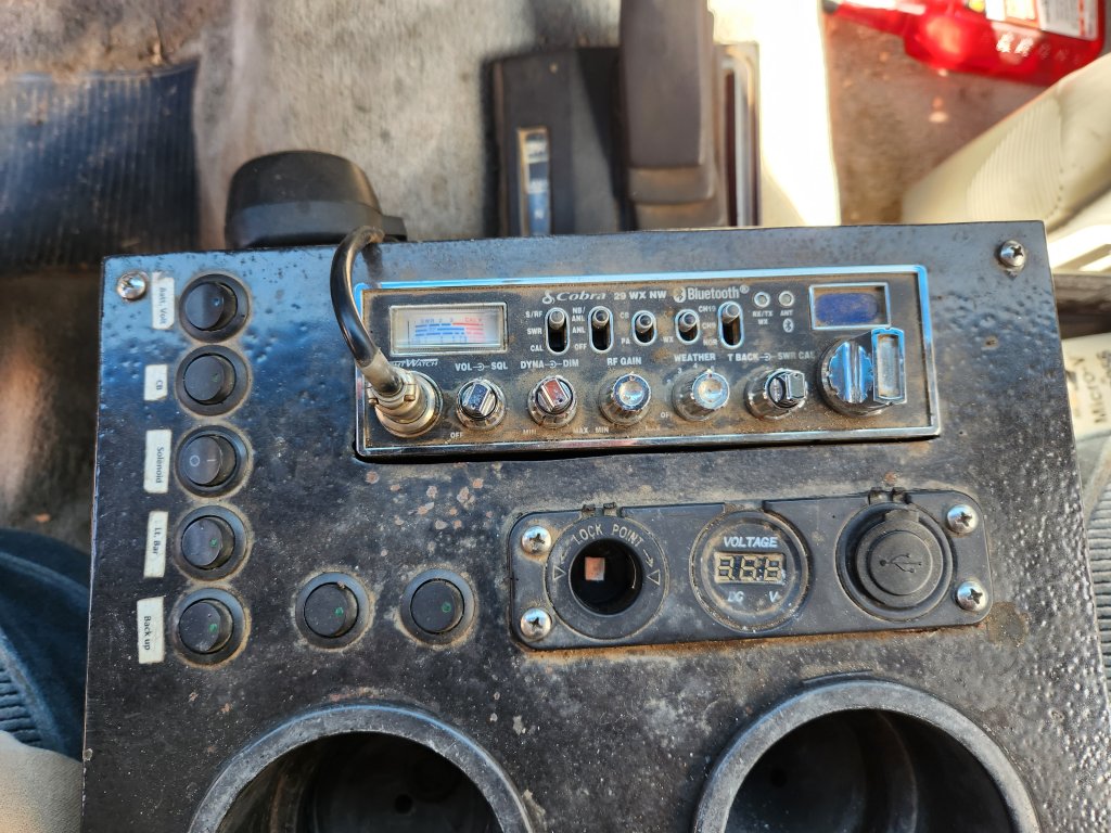

Okay if that solenoid is triggered via a toggle switch. Dirt simple,disconnect dead battery negative cable, hook a jumper cable from good battery positive to junk battery positive. Do your lights etc work? If so great,move on, move the jumper cable from dead battery positive to the unused large solenoid post. Flip your toggle,do your lights work,turn the toggle off, did they go out. If so everything works. Change the battery and add a 16 gauge wire with a 20 amp fuse from B+ on good battery to unused big post on solenoid. Flip the toggle when you want to charge battery number 2. I'd move the trigger from the toggle to an exciter that was on anytime the engine was running. But baby steps, let's get it working first,we can make it fancy later.I will get more and better pics soon. I dont have a test light or multimeter,yet, but the deep cycle batt is dead. And nothing is tapped into the charging system yet. The po did use a toggle to trigger the solenoid. It is on the center console.
