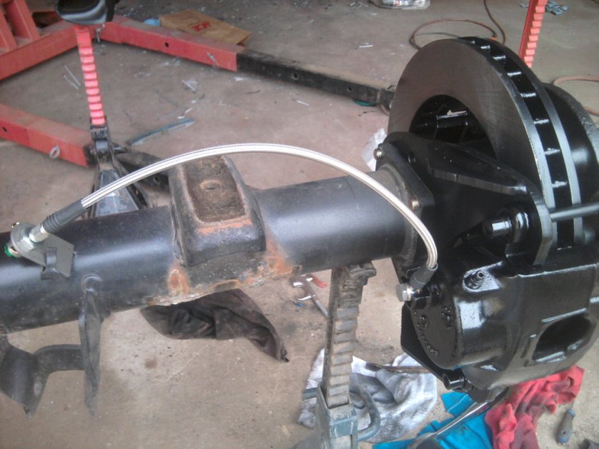

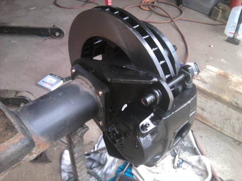

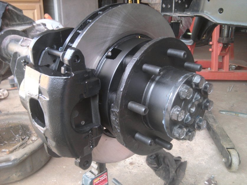

what axle do you have 14 bolt full floater or semi floater
diyx4x.com has a awesome disc brake bracket I have used it many times. it uses a front 3/4 ton rotor and caliper
