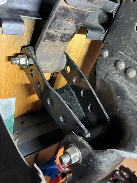

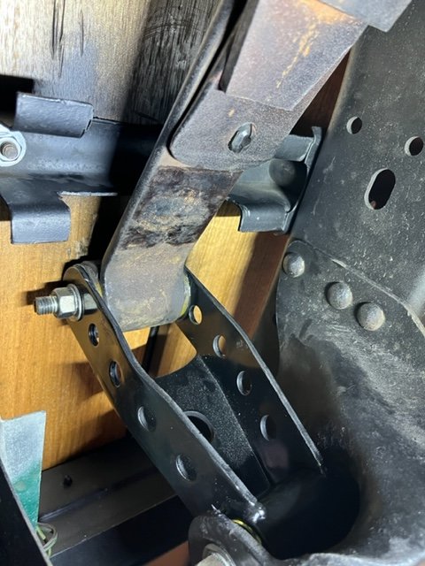

I've just installed these drop shackles, but they are hitting the bed.
How do I fix it without having to raise the bed?

Looks like you'll either have to shave the wood in that area, or move the springs to the next hole in the shackles and trim the shackles. That 1" difference will raise the truck about half an inch.

I ended up cutting the shackles
