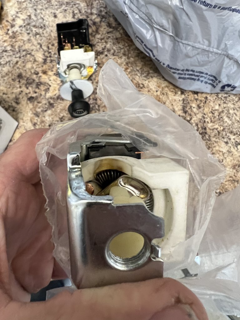

Bought new headlight switch today and as soon as i put on headlights it started smoking and melting, but fuse did not blow. The part had been opened (plastic bag open inside box and looked like it was handled at least) bought from NAPA. They are getting me a new one Monday.

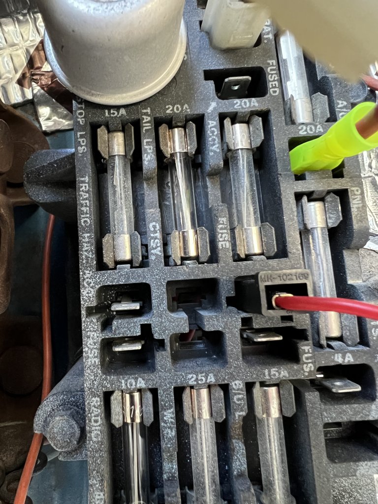

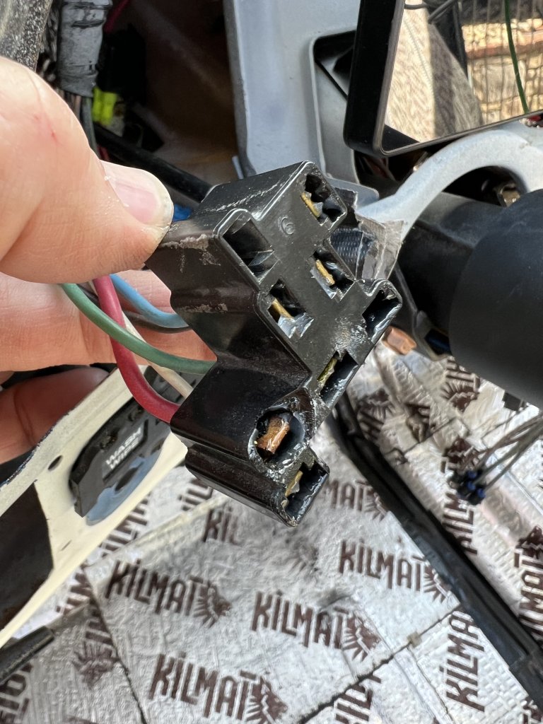

So it’s blowing the tail lamp courtesy fuse here, 20A. The first headlight switch was new in February this year with no problems. Now, the only new thing is Vintage Air instal a few weeks ago and had to tap into dash lights to get back lighting for VA control panel which is LED. It has worked fine so far until we found the fuse blown a few nights ago. Here is a pic of the connector as well, but as far as we can see there is no contact with the ground post when installed.
And again, everything works until you turn the know to adjust interior light backlighting brightness, blows the fuse.

that connector has some melt and the copper isnt clear. if you know how to depin that i would clean up the copper and then reinsert. your tail lamp ground on driver rear should be checked too, and the connector on the frame rail that the tail lamp harness comes off of, they are possibly having issues. Corrosion at every point could theroetically be enough to cause a overly large draw
also, check your bulb sockets like for the tabs in them under the bulbs, maybe pull some bulbs out of each side and then put fise back, see if you pop when you have much less load
