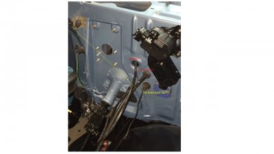

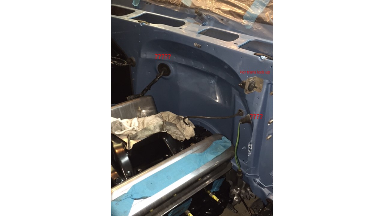

Hey guys,
just dropped in my motor and gonna start the wiring.
Can ya'll tell me what these wires are for and if I need them.
I do not have a lock up tranny.
thanks a bunch !

The wires to the left of the motor are to your ECM, it is located usually behind you glove box. Are you running an HEI distributor? if so you definetly do NOT need them wires. They are for the ESC style dist. computer controlled.
