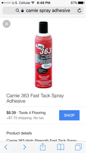

I want to know what adhesive so I can get some I've tried the 3m crap 77 and 90 not impressed by either.
The adhesive is a high tack spray headliner spray adhesive. The particular brand is a private label that my local upholstery supply center carries. Most upholstery supply stores should be able to direct you to a comparable product if you explain what you are wanting to do.
I agree over the years I have tried several different products and the 3m is crap. the trick is the "web" consistency of the Adhesive.

no upholstery shops here that's the problem. We only have a couple craft/hobby stores and those are like an hou ror more away and we do have a body shop supply store though thankfully. Anymore I've been buying all my stuff online.
I used the 3, 77 and it didn't "web" really but the super strength 90 did and it did hold up decent for a headliner I did once.
